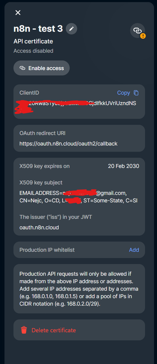

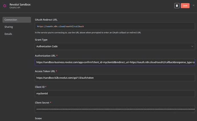

here is my credentials setup:
  • I used the OAuth Redirect URL provided by N8N for JWT generation
  • auth url is the same as you would click in the Revolut page → Enable access / written in docs
  • access token URL is the same as in docs
  • client secret is my client_assertion/JWT generated via my CLI
  • Authentication is set to: Body

Hey everyone, managed to find a dirty solution by skipping n8n’s authentication and just using my refresh tokens directly. Works for now, will see if it breaks later, fingers crossed.
If it helps anyone :+1:
I’ve had a decent amount of issues with n8n’s Oauth2 implementation. Even when using the generic Oauth2 credential type and setting things up correctly. I’ve had tokens not get refreshed for seemingly no good reason, and could prove n8n was not refreshing properly.
This is one of the reasons why I wish n8n would give Variables to everyone, would allow for much easier manual Oauth2 implementations with workflows.
When this happens I setup a refresh workflow and store the tokens somewhere safe and just fetch when needed.
