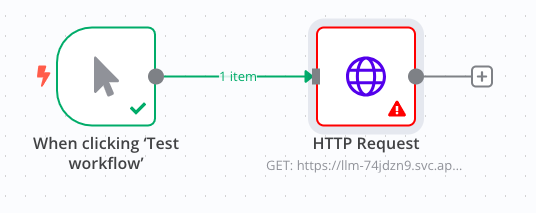

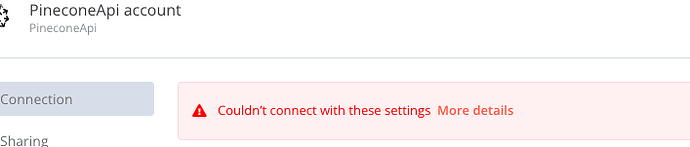

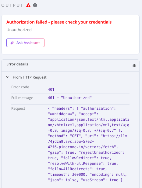

I am encountering issues when trying to connect Pinecone to n8n. The main issue is that I cannot add the API key to the credentials section. Additionally, I receive a 401 Unauthorized error when trying to access Pinecone via HTTP requests in n8n, even though my API key is valid.
What is the error message ?
401 Unauthorized

I am unable to add the API key under credentials, which might be causing the issue.

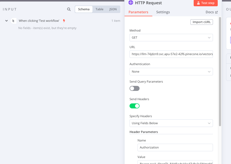

Be careful with screenshots of api keys. you should reset that key, some of it is visible.
I don’t think you need the “Bearer” with pinecone.
Here is the curl from their docs:
curl -s "https://api.pinecone.io/indexes" \
    -H "Api-Key: YOUR_API_KEY" \  < -------- no Bearer
try to add it without the “Bearer”. and best practice is to use api keys in the credentials, otherwise it will be stored in plain text unencrypted.
Thank you for the heads-up, I’ll reset the API key. You’re right, the ‘Bearer’ is not needed for Pinecone. I’ll also set up the API keys in the credentials for better security. Also, I noticed there’s a Pinecone vector store available for managing connections with Pinecone natively. Thanks!
