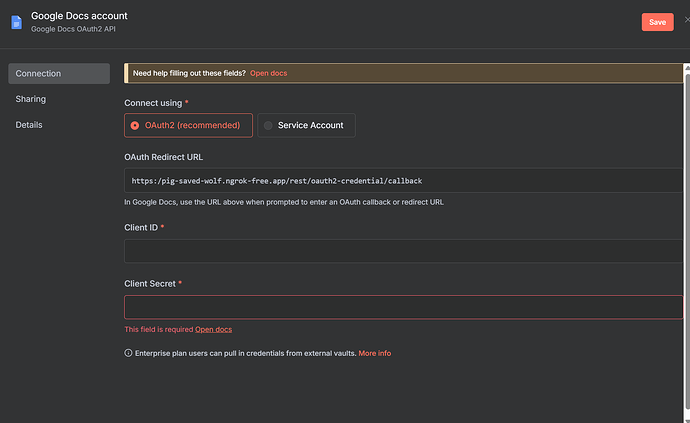

Your problem comes likely from using localhost for redirect url. You can’t, google cannot redirect to localhost. Google needs to redirect back to your n8n instance. For this you need to specify WEBHOOK_URL for your n8n instance.
If using docker compose:
i am running n8n on a windows laptop and dont understand what a webhook is can you pls explain
A webhook url here is URL that Google needs to call to reach your instance during the OAuth process. If you need to get a public IP with HTTPs to provide to Google for the redurect url, you can use NGROK for that:
i did as the video said and have set up ngrok and made new n8n contaner, but when i add the redirect link in the google consol redirect address it give me an error “Invalid Redirect: must contain a domain.“ here is the redirect link
I just tried your url in my console and it worked without any issues:
https://pig-saved-wolf.ngrok-free.app/rest/oauth2-credential/callback
I guess you found your mistake - a missing slash symbol after the schema.
