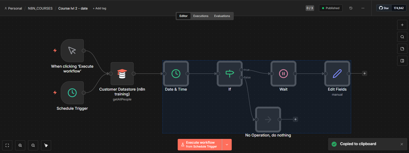

Hello. I am having issues with copying and pasting nodes. I’m running on a local server, using the Docker option with version 2.7.5 of n8n.
It doesn’t work in the same workflow nor in different workflows. I can see the duplicate option, but only when selecting a node in the same workflow. The copy option seems to work.
I checked a few of the questions and am wondering if it’s related to the current version.
I appreciate your assistance,

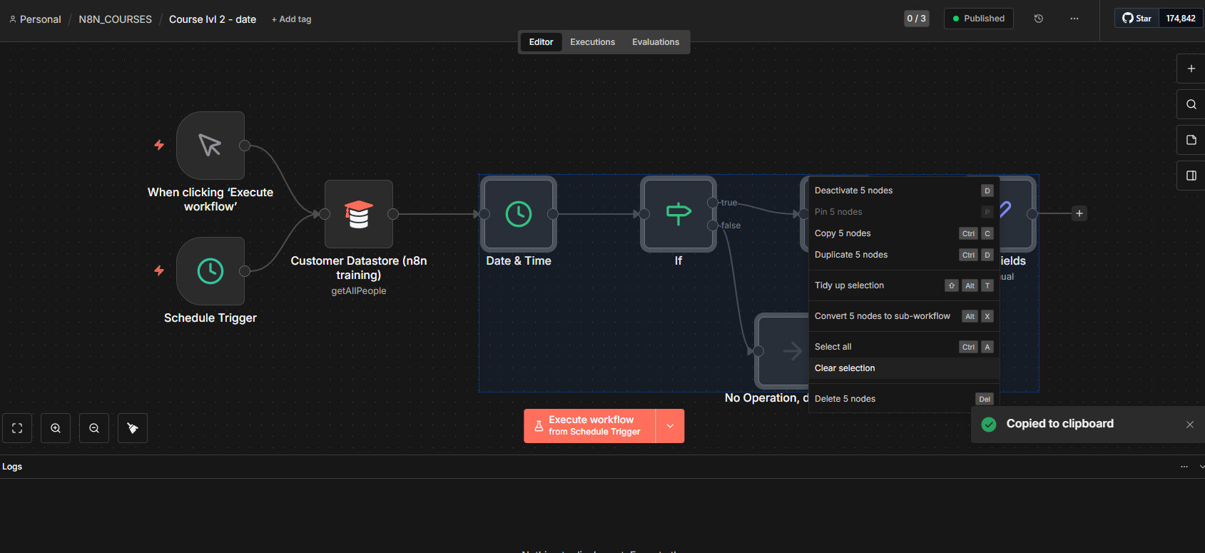

No error message, but I can copy the node, but cannot past:
Also unable to paste the entire workflow in here.
N/A

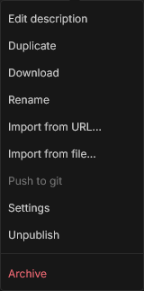

Hi @Calves Have you tried using:
Import options? Does they show the same behavior in your n8n instance?
Hello @Anshul_Namdev, thank you for your response.
The import options work correctly. I believe the other options as well. Just the “paste” option doesn’t show at all.

Yes. I can actually see the Copy command working. But for some reason, after that the Ctrl + V doesn’t work, and there’s no paste command available either.
Yes, my keyboard is the English standard.

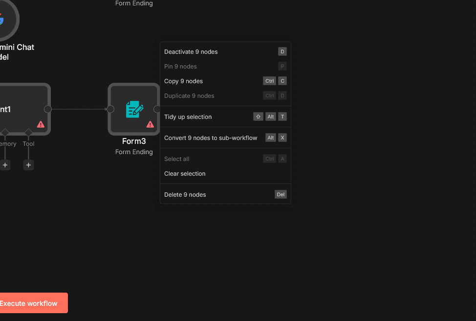

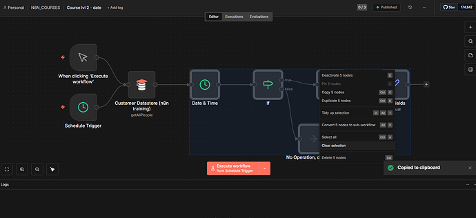

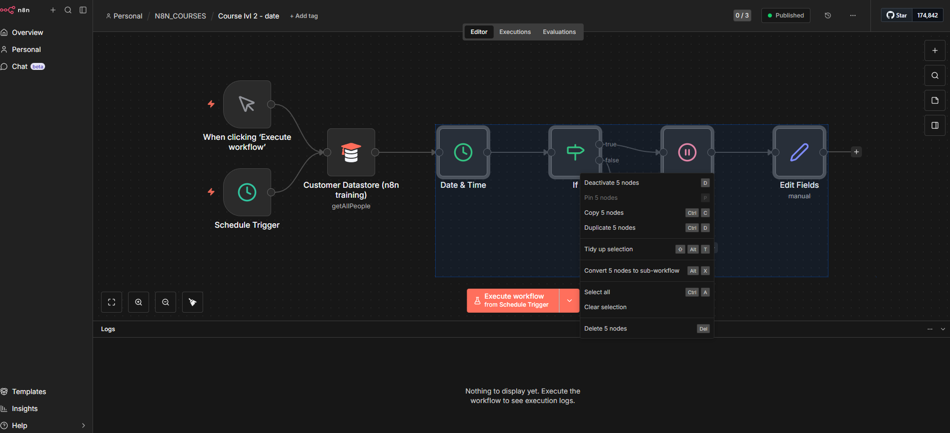

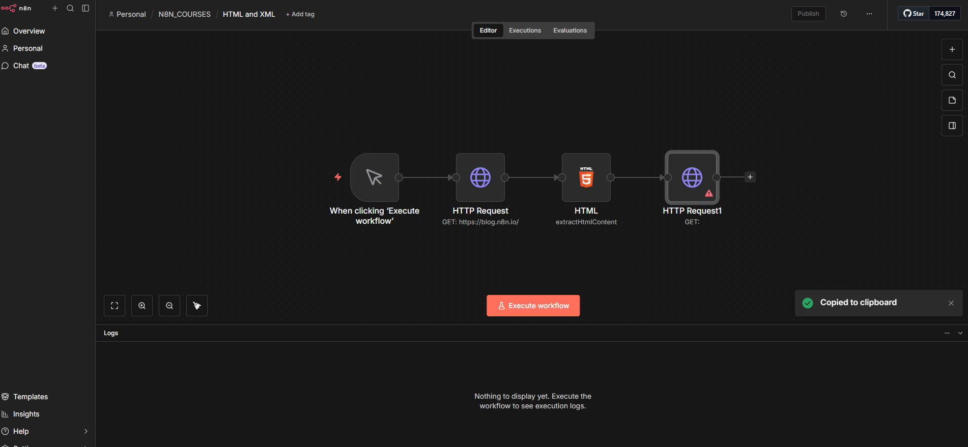

Screenshots:
But the paste doesn’t work.
There is the “Duplicate” option, but that one works only for this workflow.
