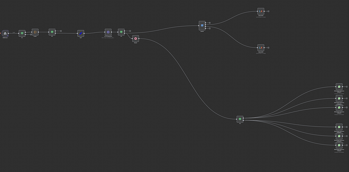

Unable to finish a workflow
I am unable to finish a workflow without error - it throws an error in the last node mentioning “All nodes have not been run between start and end”
pairedItem can’t be found when intermediate nodes between ‘Webhook‘ and ‘WhatsApp Business Cloud11 have not executed yet.

hello @pingmepi
use $('Webhook').first().json instead of the $('Webhook').item.json. When you have multiple outbound connections to nodes, you can’t use .item.json property
Thanks @barn4k - this successfully ran!
Had the same issue and worked for me now. Thanks
