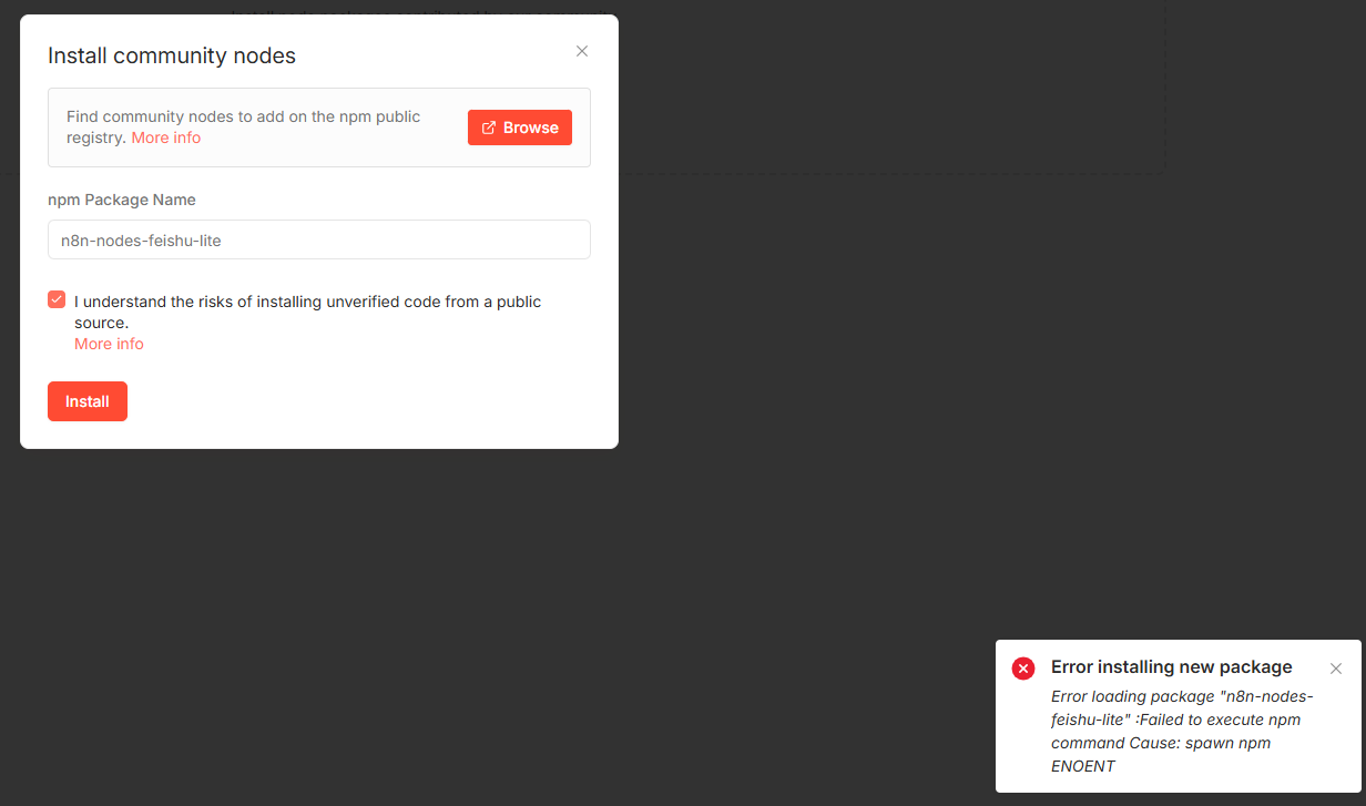

When I install a node in the community, the bottom right corner shows Error loading package “n8n-nodes-feishu-lite”: Failed to execute npm command Cause: spawn npm ENOENT
I tried another blogger’s method, checked the node path and npm version, and all these installations were fine. Then I also deleted the leftover node files and chose to reinstall, but the same error still occurred.
Error loading package “n8n-nodes-feishu-lite” :Failed to execute npm command Cause: spawn npm ENOENT

Hi @Rorschach , this is a known Windows bug, on Windows, npm runs as npm.cmd but n8n looks for plain npm, so it can’t find it and throws ENOENT.
Two fixes:
Option 1: Install the community node manually via command line instead of the UI:
cd ~/.n8n
npm install n8n-nodes-feishu-lite
Then restart n8n.
Option 2 Source code fix (if you need UI installs to work): Edit this file: C:\Users\YourUsername\AppData\Roaming\npm\node_modules\n8n\dist\modules\community-packages\community-packages.service.js
Find the asyncExecFile('npm', ...) call and add shell: true to its options. This is the fix documented in GitHub issue #22706 .

I have already tried this solution, but it doesn’t work. The error message still persists
I will try the second plan you gave me and inform you of the outcome. Thank you
Thank you. I will give this plan a try
I tried manual installation and it has been successful so far. Thank you for your advice!
