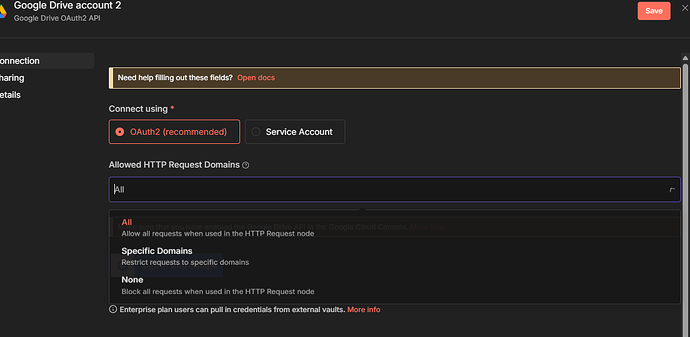

Unable to locate URL to link Google Drive Account
I am unable to find URL in N8N to link Google Drive. I tried to create new credential but still I cant view URL
Can you please let me know the option to resolve the issue.

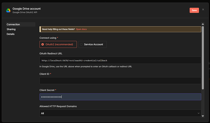

Hello @Suman_Sakleshpur_Rud ,
Try this:
• Open the Google Drive node and select “Create New Credential.”
• Look for the field labeled OAuth Redirect URL (it usually looks like
https://.../rest/oauth2-credential/callback).
• Copy that string exactly.
• Go to your Google Cloud Console > APIs & Services > Credentials.
• Paste it into the “Authorized redirect URIs” field for your OAuth 2.0 Client ID.
Guide: Google credentials | n8n Docs
Let me know if you get that green “Connected” message.

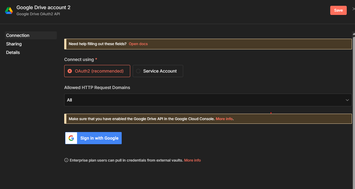

Hello A_A4 Thank you.
I cant view URL if i select create new credential in N8N
That “Sign in with Google” button in your screenshot indicates n8n is trying to use a managed authentication flow, which hides the manual configuration fields like the “Redirect URL.”
To guide you to the right setting to reveal them, I need to check your specific environment.
Quick questions:
• Which n8n version are you running? (You can usually see this in the bottom-left corner or the “About” menu).
• Are you self-hosting (Docker/Desktop) or using n8n Cloud?
• Do you see a toggle or dropdown option in that window labeled “Use my own credentials” or “Generic Auth”?
Let me know your version, and I will help you unlock those hidden fields.
I am using 2..7.5 (Latest Stable) and I am doing Self-hosting and please find the screenshot
This issue is happening because you have the N8N_DEFAULT_LOCALE environment variable set in your Docker configuration.

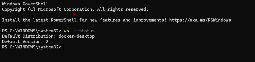

I just started to learn about AI automation. I am not sure where to check if WSL is installed correctly.
Thank you
in PowerShell type;
wsl --status
If it is correctly installed, it will show you the version
if there is a problem, type:
wsl --install
after that check the destribution:
wsl -l -v
the answer should be something like:
NAME      STATE           VERSION
Ubuntu    Running         2
in all cases, the version should be 2 and over not 1 at all

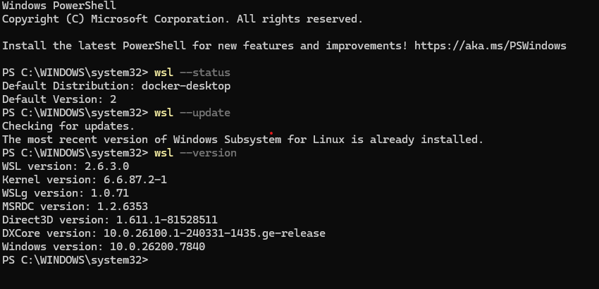

currently the version is 2. Please let me know if the version is latest
run
wsl --update
for detailed
 wsl --version
if still spinning, it maybe:
  1. WSL not installed
  2. WSL version is 1 instead of 2
  3. VirtualMachinePlatform not enabled
  4. BIOS virtualization disabled
  5. Corrupted docker-desktop WSL distro
if 1 and 2 is correct, the image shows that wsl is OK, try to run it manually, or see option 3
now, VirtualMachinePlatform may be the problem:
in powershell
Get-WindowsOptionalFeature -Online -FeatureName VirtualMachinePlatform
if it says: State : Disabled, you need to enable:
Enable-WindowsOptionalFeature -Online -FeatureName VirtualMachinePlatform -All -NoRestart
then
Enable-WindowsOptionalFeature -Online -FeatureName Microsoft-Windows-Subsystem-Linux -All -NoRestart
if it continue spinning, we will check CPU, tell me please
Thank you for your help.
The current version is updated hopefully it should work
