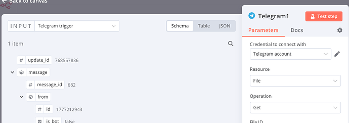

HI! I was wondering if someone could help me… I think Its I easy solution but Im not seeing it. Im trying to pass a file from telegram to n8n, and then i send it to flowise by http request.(Flowise has overrideConfig field where I can pass the text of the pdf or maybe the pdf itself to be use it in a chat with a local model)
Im not able to make the request, either says json is not valid json or “PDF Strem must have data” seems like the problem is that is empty…but its not.

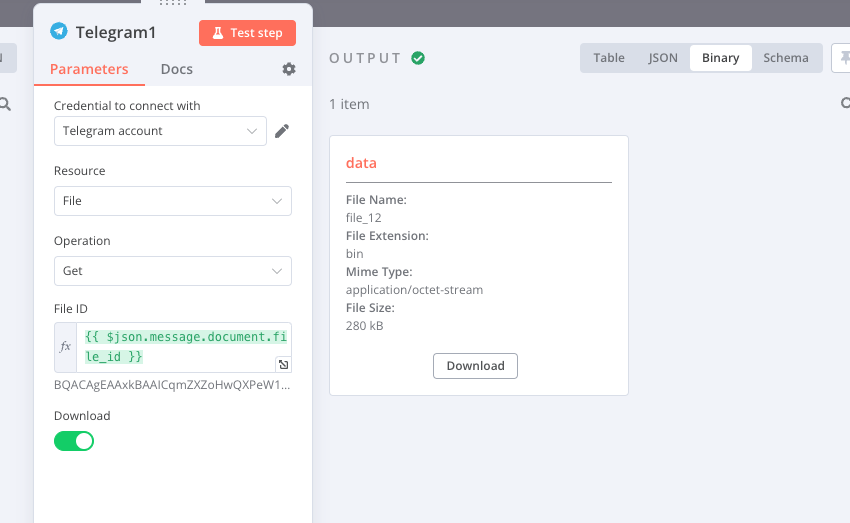

If you want to pass on the content of the pdf, you can use Extract from File node to convert binary data to JSON like so:
If this doesn’t help, could you maybe share how you’re making the http request to Flowise?
