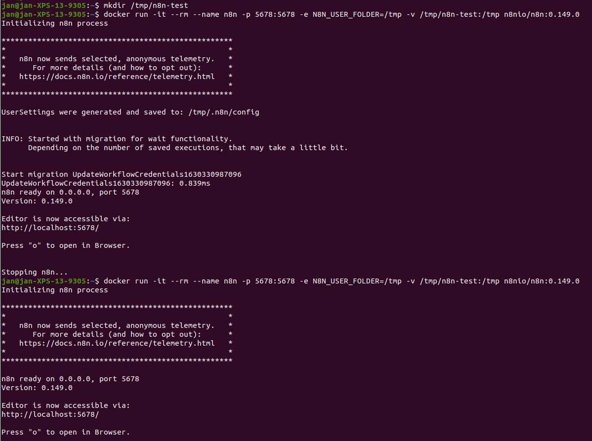

I just tested. Works perfectly fine:
First start: it does not exist, so it creates it
Second start: it does already exist so it does not create anything and just uses it
So I assume there must be a different issue like that the environment variable does not get set correctly, the folder does not get persisted, …?
