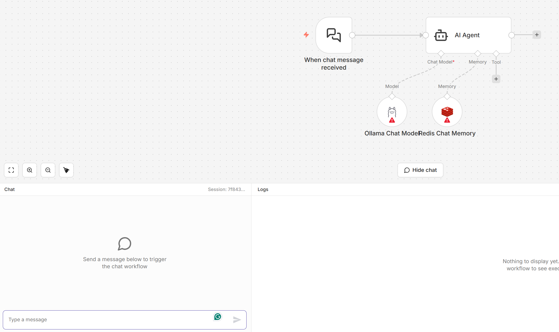

When running a workflow which starts with a chat input via the n8n web gui, the workflow does not progress.
The chat window has a pop-up appear saying “Waiting for you to submit the chat”. The N8N web GUI chat window shows the spinner for a second or two then says ‘Error: Failed to receive response’. A square button also appears at the bottom center of the workflow window with the hint of ‘Stop waiting for webhook call‘.

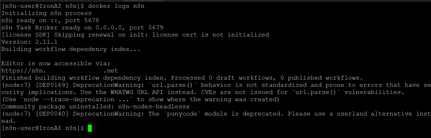

There are no errors in the docker logs for both n8n and n8n-runners. If ‘feels‘ like the n8n web gui is not sending the chat message to the workflow node in a way it is expecting.
I have removed the n8n and n8n-runners containers and restarted with no change. I have recreated the chat trigger, with no change. I have also tried adding a chat message node at the end of the workflow and setting the chat trigger node to response mode, but again no change.

“Waiting for you to submit the chat” –> ‘Error: Failed to receive response’

  1. I put in a chat message.
  2. I click the go / send / post button
  3. The message comes up on the chat node instantly and the ‘stop webhook waiting‘ button also appears.
  4. After a second or two the message in the chat response window appears.

No error messages appear int he docker logs.
