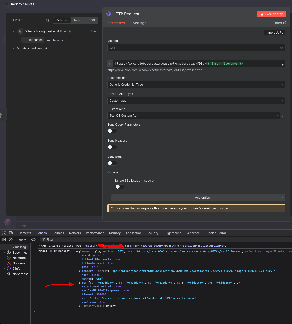

Browser debug logs shows “qs” params as
Debug info
core
  • n8nVersion: 1.108.1
  • nodeJsVersion: 22.17.0
  • database: sqlite
  • executionMode: regular
You can check the request sent by the HTTP Request node in the web console. I tested your exact workflow and it does send qs:

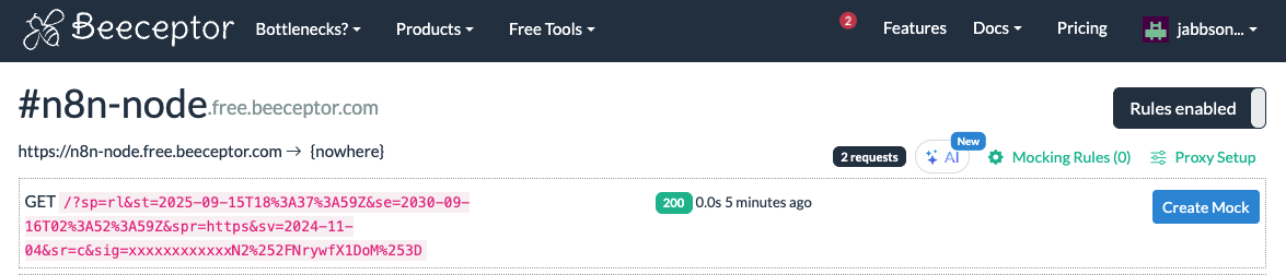

You can also verify the functionality by sending the request to one of the echo or test servers, for instance I changed the URL and sent it to inspect the path:
Thanks for confirming. When I use the qs option, I don’t even see an event in the storage account’s logs. Additionally, I get this text in the reply, so I’m thinking there is an Azure+qs disconnect that I must work through.
Error code
403
Full message
403 - "<?xml version=\"1.0\" encoding=\"utf-8\"?><Error><Code>AuthenticationFailed</Code><Message>Server failed to authenticate the request. Make sure the value of Authorization header is formed correctly including the signature.\nRequestId:a18cd513-401e-005e-0d7b-2657a5000000\nTime:2025-09-15T20:03:33.2608952Z</Message><AuthenticationErrorDetail>Signature fields not well formed.</AuthenticationErrorDetail></Error>"
For anyone else who is working with Azure SAS tokens, the Azure UI presents the token already-encoded for HTTP.
This encoding needs to be reversed so that npm qs doen’t double-encode.
