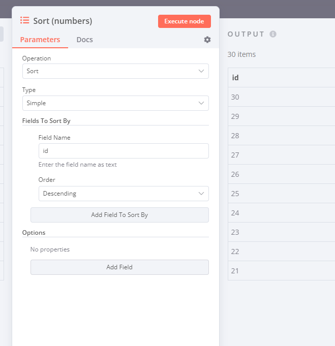

Hi @mmac, I think you might be spot on here, this very much looks like numbers formatted as strings. I don’t have a Google Analytics account to check this firsthand, but you could verify this by switching to the JSON view.
Integers wouldn’t have quotes around them:
But strings would:
If you need to convert a strings into integers, you could use parseInt() in an expression (such as {{ parseInt($json.total) }} where total is your field name).
Here’s an example workflow showing the idea and the difference between strings and integers:
Numbers:
Strings:
Hope this helps! Let know if you have any questions on this.
