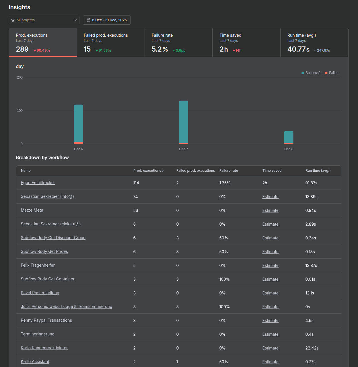

Interestingly, we cannot see these high numbers in the Insights dashboard of our n8n installation. It rather seems broken, since it only shows executions for a few days and 0 on all other days. For some users (who are admins), Insights does not show any execution numbers at all. Is it possible that we broke the data consistency in our database somehow? Timing-wise, we switched from SQLite to PostgreSQL one month ago.

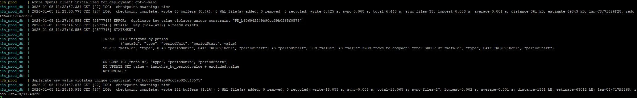

  • an error from our logs which is suspicious,
  • a screenshot showing the faulty results of Insights (everything later than 8th of December is 0),

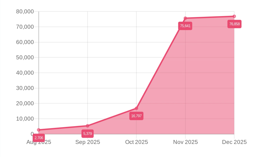

  • and a few mail reports related to our execution count reported by n8n.

I see the issue now — that log error is the key:
duplicate key value violates unique constraint
Key (id)=(4317) already exists
INSERT INTO insights_by_period
Your SQLite → Postgres migration left duplicate records in the insights_by_period table. n8n is trying to insert new stats but hitting conflicts with old data.

Am I wrong or is it possible that the counts reported by the weekly n8n report are not valid? These seem at least buggy. Every report we receive refers to the same date “8 Dec 2025 | n8n | you’ve used 50.5% of your annual executions quota”. Unfortunately, the report does not give any insights such that we could compare our findings.

Edit: Insights might be fixed now. Looks like It was the sequence id being out of sync. Thanks for direction on that. Interestingly there is a huge gap between execution count in insights and n8n mail report. Numbers of insight tab actually match pretty much executions that are triggered, that is, all runs except inactive flows and subflow calls.
