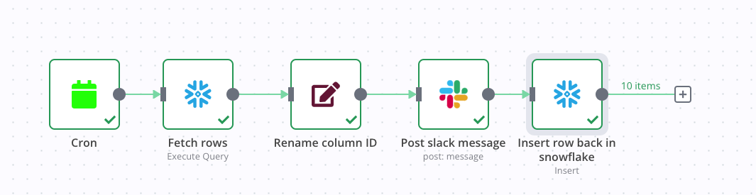

Hi ! I’m trying to create a workflow in which one of the steps is to insert a row in snowflake, based on data that is fetched in previous tasks.
The target table only have one column named ID

I believe that I have not configured the node properly.
I tried to replace the value in the columns placeholder by the name of the column (id) : I don’t see any error but all values are null

So i added the rename key as suggested
But wen trying to execute the insert node I still get empty results
It seems that the column is found, but not the values of the rows
Hi @ThomasCouz, from looking at your screenshot it seems the data sent to Snowflake is coming from your Slack node which probably has a different data structure (not including an id
field). What happens when you connect your Snowflake node directly to your Rename keys node instead?
Indeeed @MutedJam you were right
If anyone reading this, here is the workflow that works correctly :
Thanks !
