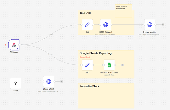

Weirdly, this was the original flow-
You can see the Start node in the corner, unused since this is never manually triggered.
After deleting that node from that workflow ( it still existed in others ), the problem continued.
One possibility in my mind is that the node has been deprecated, or that in a “disconnected” state it’s causing a failure. And that furthermore the problem is occurring at server startup and preventing the webhooks from initializing properly. It appears that if the node exists in any workflow, it will cause all of them to hard fail with no logging.
I’ve removed the start node from all workflows, to be safe, however I’m cautious about re-upgrading n8n it to the current build, since this is a production system.
Hoping I can get some clarity on this and how to approach it. Thanks a ton!
