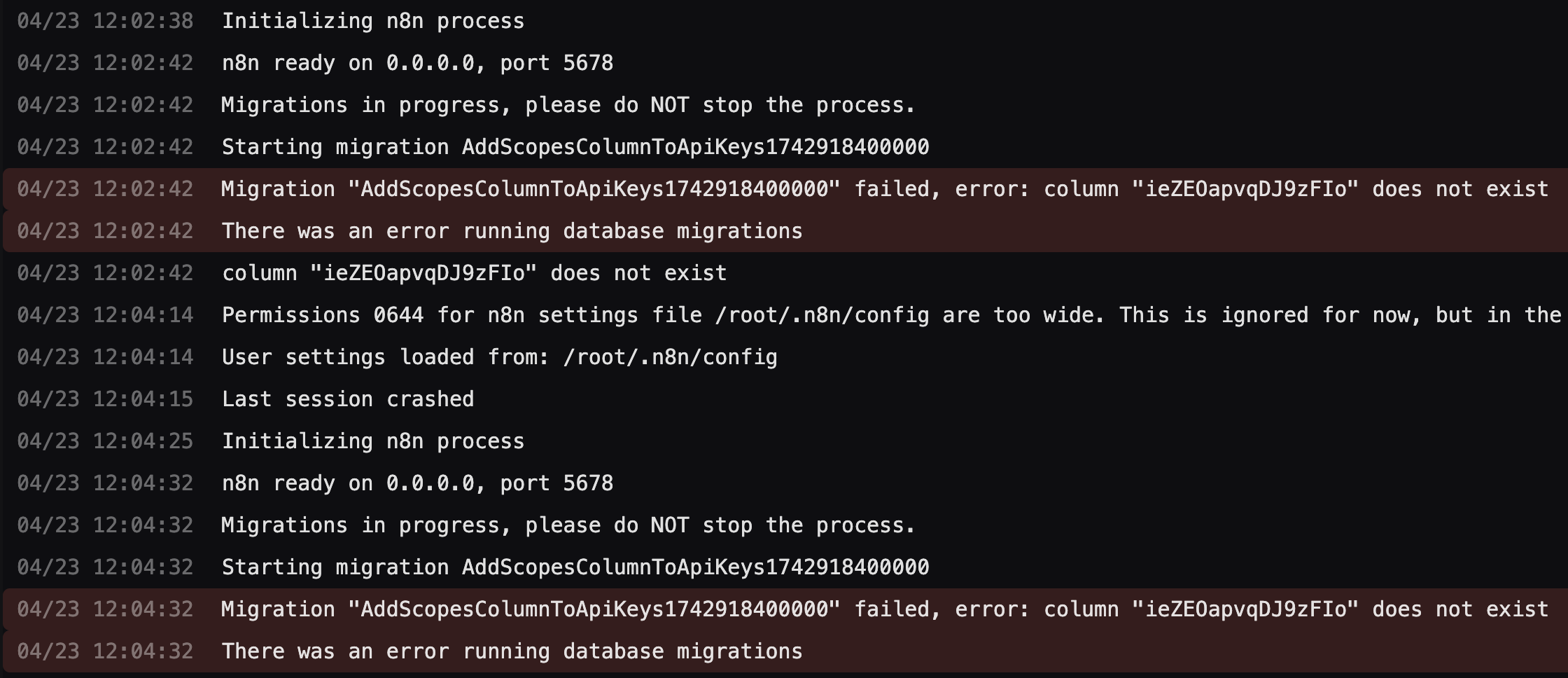

When I try to update from 1.88 to 1.90
The server is responding this error
Migration "AddScopesColumnToApiKeys1742918400000" failed, error: column "ieZEOapvqDJ9zFIo" does not exist
There was an error running database migrations
After the crash. I update to 1.89.2 then everything is fine.
Guess it ran into issue with the API scope somehow?

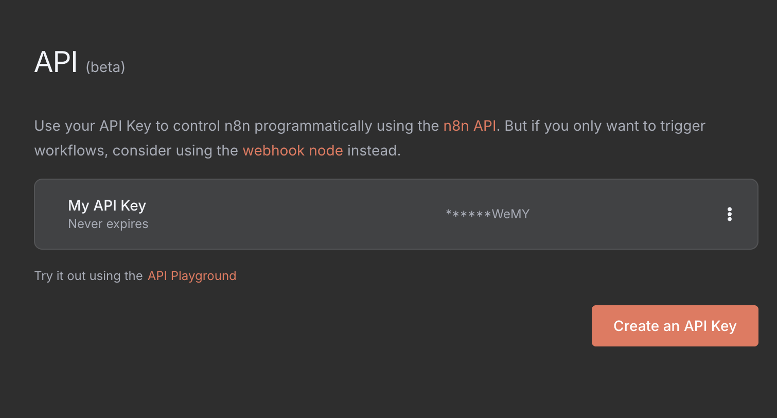

I created an API key before.
Hi,
This was reported and fixed in 1.90.1

I also try to delete the original API Key then update to 1.90.0 without error
