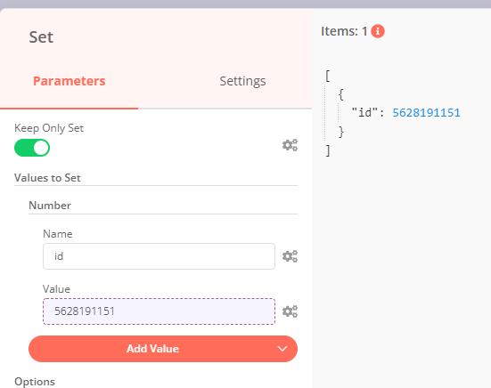

parseInt() is a great idea but works slightly different from .toString(). Could you try {{parseInt($node["Webhook"].json["body"]["event_data"]["id"])}}? This should return a number:
In n8n’s JSON view you can easily differentiate numbers and strings btw which might help with quickly checking the results. Strings will have double quotes " around them, numbers won’t have these):
