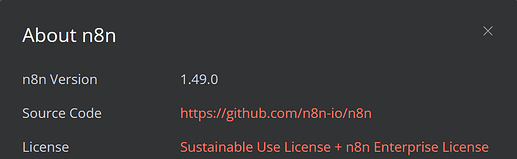

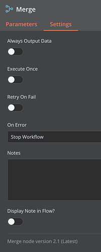

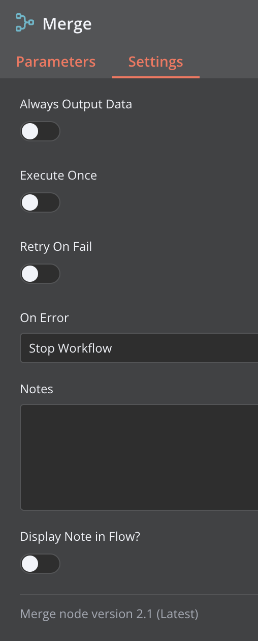

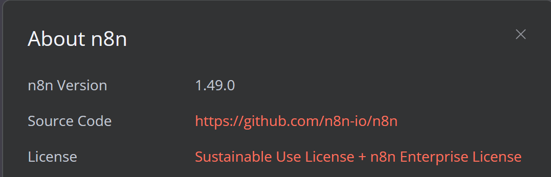

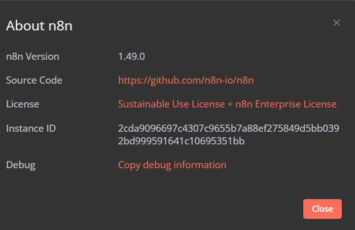

Hey, I’ve just updated my instance of n8n to 1.49.0 but I’m not getting the new Merge node, any idea why? Merge node shows version 2.1 (Latest)?

@mariana-na, Self-hosted, I’ve restarted but no update.
I’ve tried on 2 instances, same results on both. Both are on different servers with different configs.

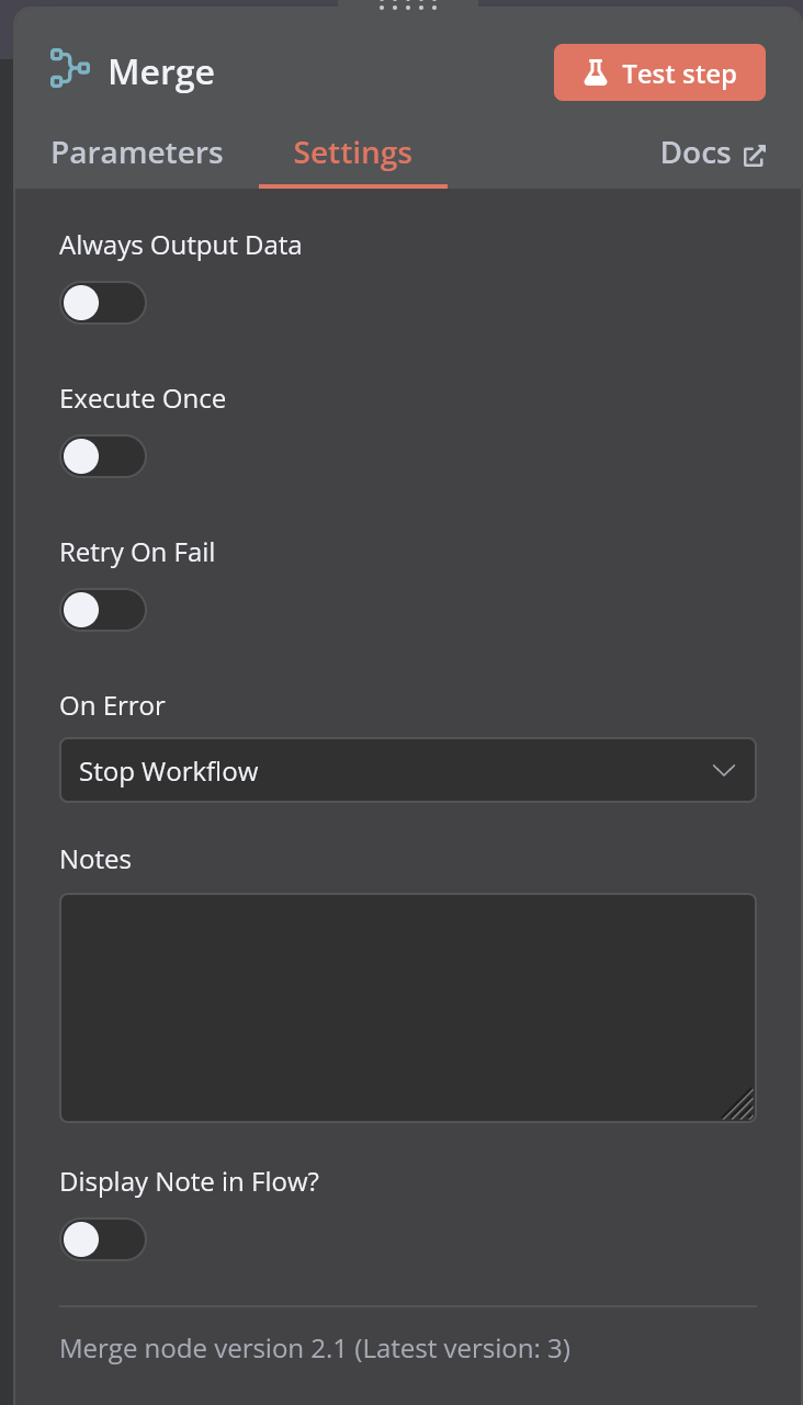

Hm… I see the same on my cloud instance
But on my internal instance there is a new version…

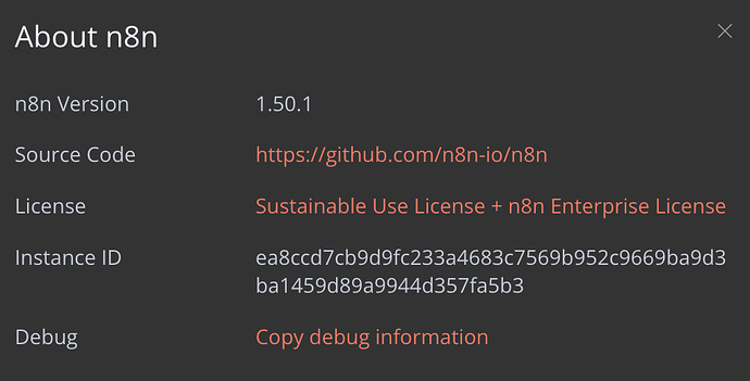

Maybe there is something with the v1.50.1?

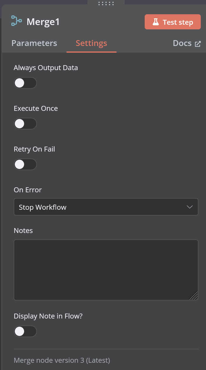

I updated a cloud instance to 1.49.0 this morning and the node is working as expected
But to test this I just updated an npm instance to 1.49.0 and the merge nodes I had already in workflows are on version 2.1

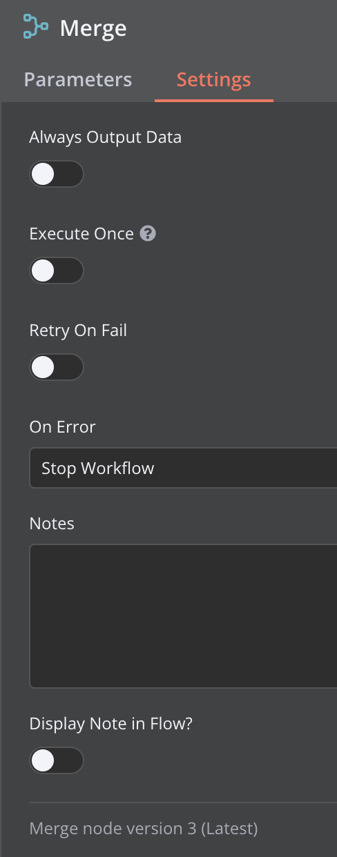

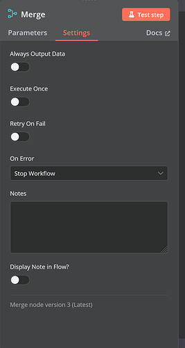

Nope, I added new Merge node, and the cloud instance (1.50.1) is showing that the latest Merge Node is v2.1, but my docker instance is on v1.49 and shows the correct v3

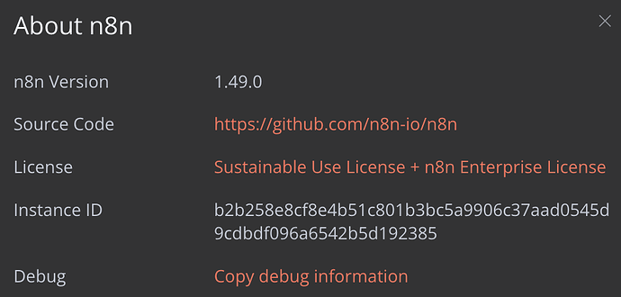

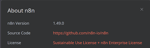

@mariana-na Ok I have everything running in docker, all using postgres databases. I have 2 instances on 1.49 with this issue. One is running on a WSL2 system on an Ubuntu 24.04 LTS Distro on my home server, the other is running on Railway.app. The execution process hasn’t been changed so I assume default.

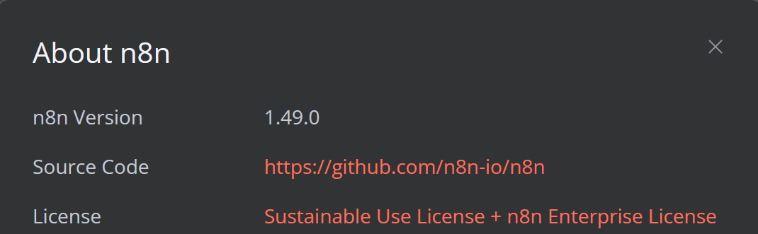

I also have another instance on a client’s Azure infrastructure on Ubuntu 24.04, they are on v1.49 also, running in Docker, and oddly, their merge nodes are v3.

I think think could be an issue of the browser cache not being revalidated. Next release should improve the cache headers. until then can you please try to hard refresh the frontend :pray:
