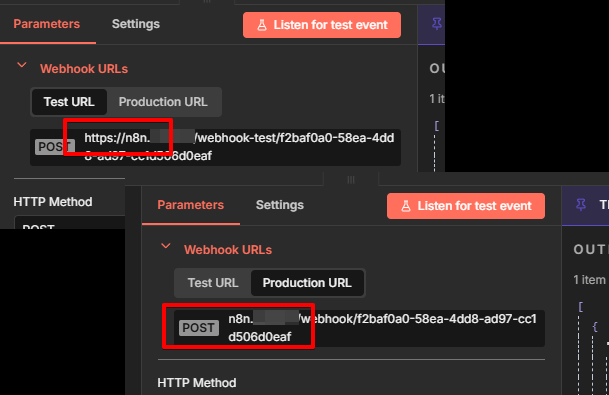

I just updated to 2.8.3 on self-hosted with Coolify, and now my Webhooks aren’t showing the “https://” as part of the link. Webhooks are still working, but clicking to copy copies them without protocol. Here are my environment variables - nothing changed…
SERVICE_FQDN_N8N=n8n.redacted
SERVICE_FQDN_N8N_5678=n8n.redacted:5678
SERVICE_URL_N8N=https://n8n.redacted
SERVICE_URL_N8N_5678=https://n8n.redacted:5678
N8N_PROTOCOL=https
N8N_HOST=${SERVICE_FQDN_N8N}
WEBHOOK_URL=${SERVICE_URL_N8N}
Clicking on a webhook shows test and production URLs without the protocol.

OK, having issues still. The test URL is showing https://, but the production URL is not.

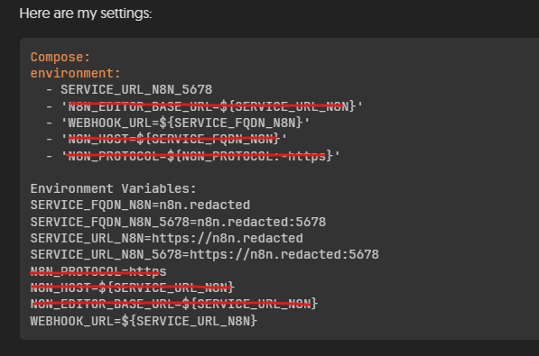

Not exactly sure what is going on, but the production URL won’t show “https://”
Here are my settings:
Compose:
environment:
- SERVICE_URL_N8N_5678
- 'N8N_EDITOR_BASE_URL=${SERVICE_URL_N8N}'
- 'WEBHOOK_URL=${SERVICE_FQDN_N8N}'
- 'N8N_HOST=${SERVICE_FQDN_N8N}'
- 'N8N_PROTOCOL=${N8N_PROTOCOL:-https}'
Environment Variables:
N8N_PROTOCOL=https
N8N_HOST=${SERVICE_URL_N8N}
any ideas?

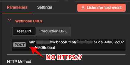

OK, did that and now both test and production don’t show “https://”. So frustrating!
Compose:
Env variables:
SERVICE_FQDN_N8N=https://n8n.redacted
SERVICE_FQDN_N8N_5678=https://n8n.redacted:5678
