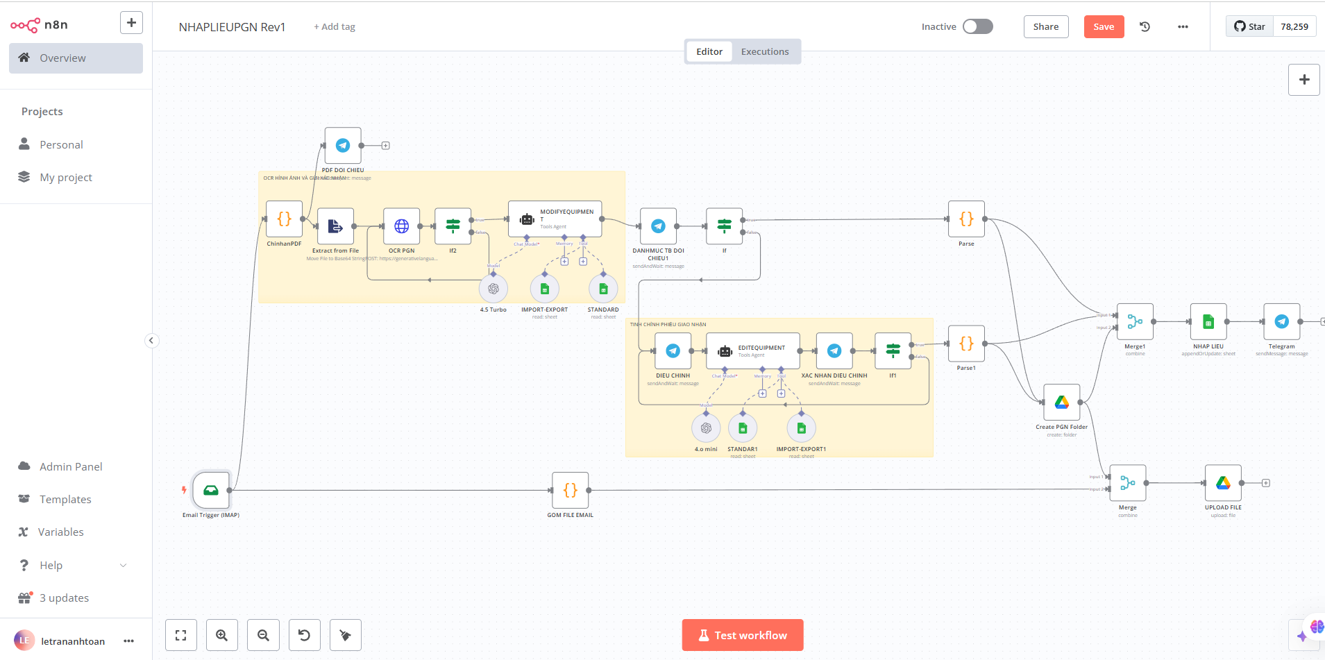

I’m having an issue with my n8n workflow that uploads email attachments (PDF and images) to Google Drive.
When I run the workflow in Test mode, everything works perfectly — all files are uploaded as expected.
However, when I enable Active mode, the workflow fails at the Upload File node with this error:
It seems like the binary data is no longer available when the execution reaches the Upload step.
:mag_right: Here’s what I’ve confirmed so far:
  • The Email Trigger (IMAP) receives emails with attachments.
  • Attachments are correctly processed and visible in Binary tab during test runs.
  • I’m merging data with metadata before uploading, using a Merge node (Mode: Merge by Index).
  • The Upload File node is configured with:
    • Input Data Field Name: data
    • File Name: {{ $json.fileName }}
    • Parent Folder: By ID from previous node
:rotating_light: Question:
How can I preserve binary data across workflow steps when running in Active mode, so the Upload File node still works?
Any help would be appreciated! :pray:
  • **n8n version: 1.86.1
  • **Database : Excel
  • **n8n EXECUTIONS_PROCESS setting : own
  • **Running n8n via : n8n cloud
  • **Operating system: Windown 10 Pro 64-bit

My workflow has been tested very stable (as shown in the picture I sent) but when in Active mode, the UploadFile node shows an error File not Found. Can you advise me?

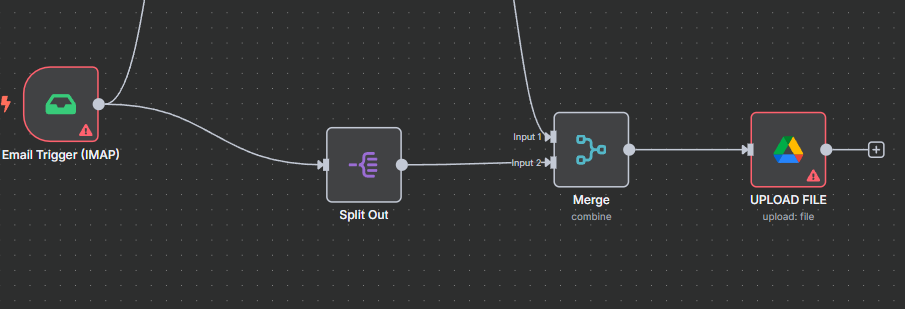

I think the merge node before the upload file is receiving an array of binary files, not just one file, because the code node before it is reproducing the binary file.
Can you try replacing the code node with a simple split-out, so it only passes the binary file?
like this:
