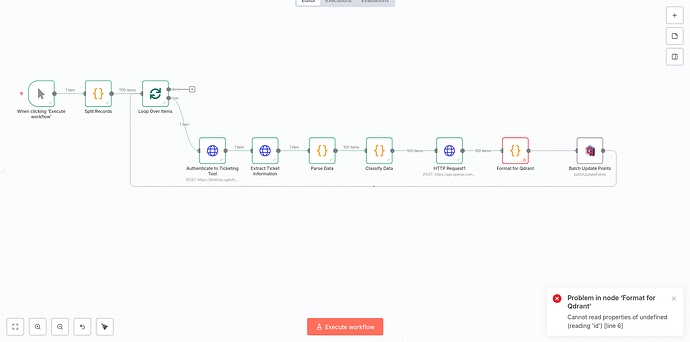

I can post a screenshot and more or less share some limited information:
Im very new to this, so im sure there are a few mistakes (as can be seen by the format for qdrant node)
Essentially, its like this:
  1. (Node 2) First I set a pagecount to iterate 1110 times through the loop (probably not the most efficient right now, but im just testing since I cant get it to work at the moment):
    const totalRecords = 110921;
    const limitPerCall = 100;
    const totalPages = Math.ceil(totalRecords / limitPerCall);
    return Array.from({ length: totalPages }, (_, i) => ({ json: { page: i + 1 } }));
  2. (Node 3) Proceed to loop 1k times (batch size 1)
  3. (Node 4 and 5) Authenticate to our ticketing tool system and extract the data I need
  4. (Node 6 - Parse Data) Simply clean up the data returned, since it doesn’t come out in a good format. I basically split the extract into 100 json items, each being one ticket of information.

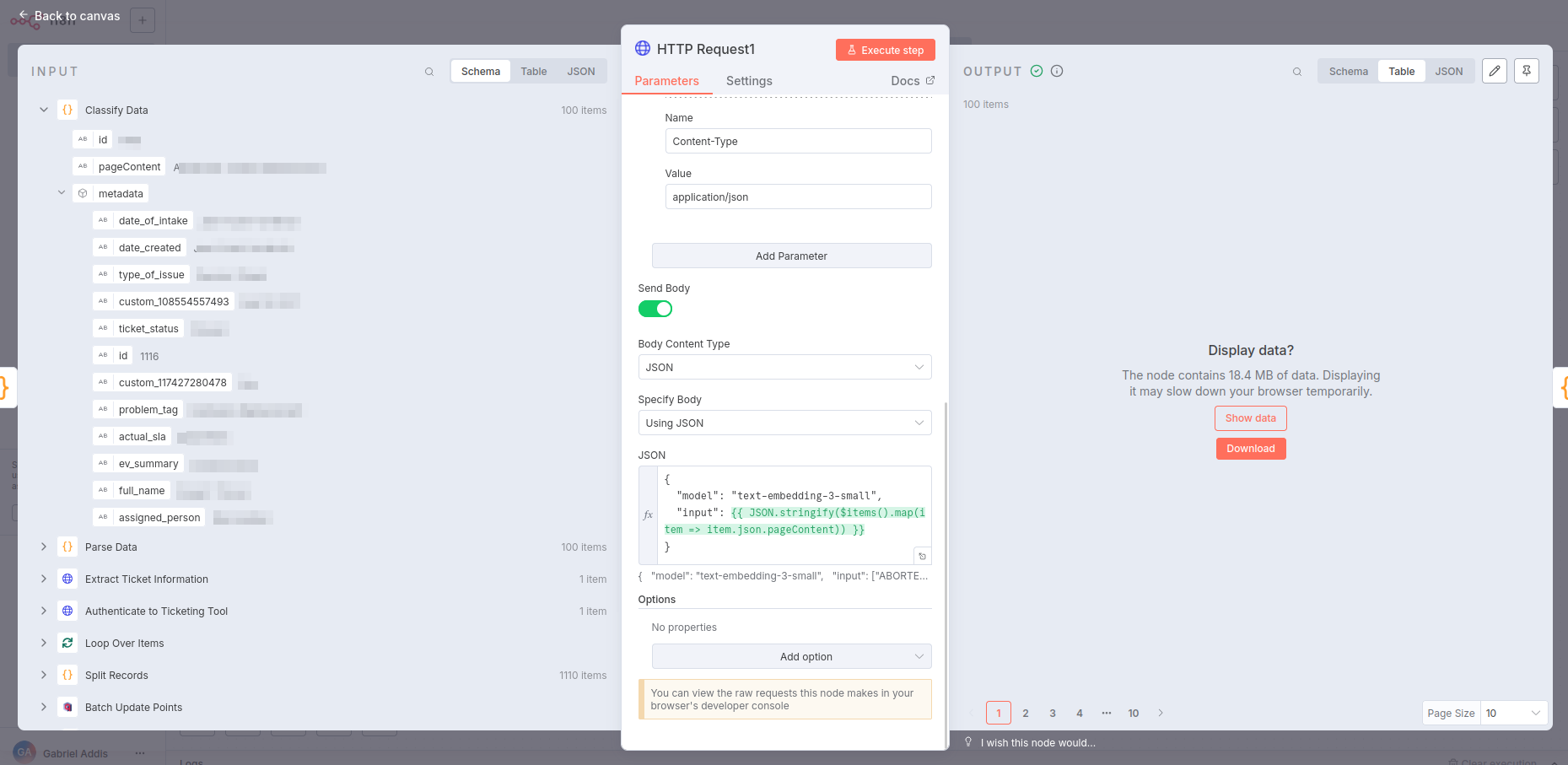

  5. (Node 7 - Classify Data) I structure the data in such a way that I get a return of 100 items, each item being a pageContent (which is basically the key information) and metadata. Example output below (sorry for blurring, have sensitive data):
    1. (Node 8) Embeddings HTTP request via OpenAI. I think its working fine, but its definitely slow now. In my previous worknode where it was a subnode, the embedding was rather quick for batches of 50 inserts, the data loader was just slow:

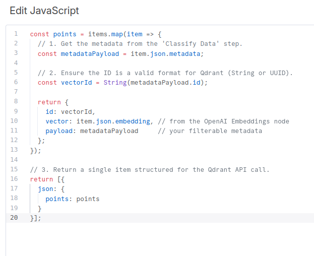

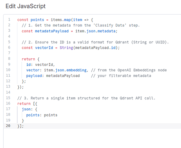

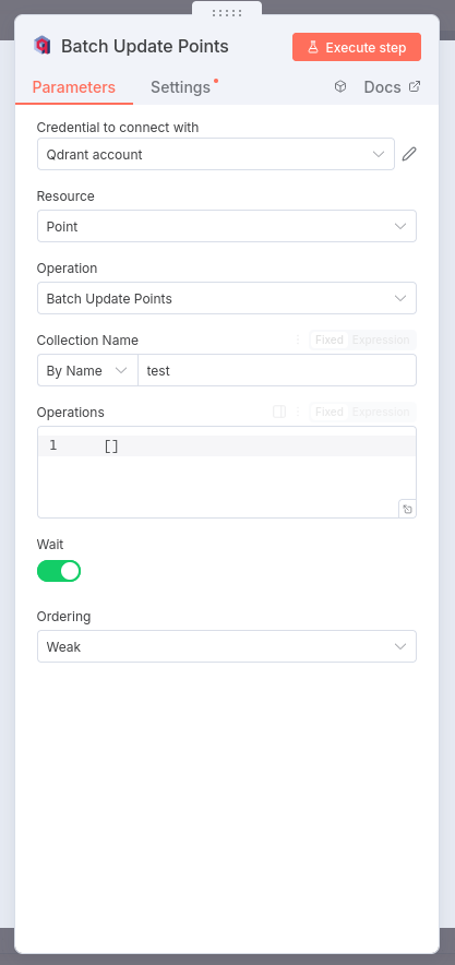

    1. (Node 9) A format for Qdrant code node that I got from ChatGPT:

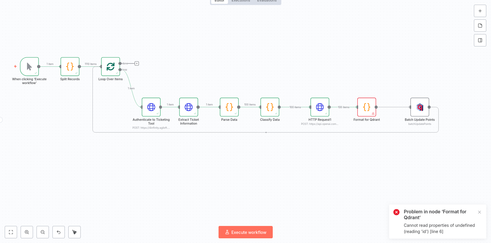

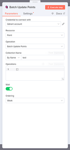

    1. (Node 10 - Qdrant Batch) Still haven’t managed to test it since I have an issue with the workflow at Node 9
