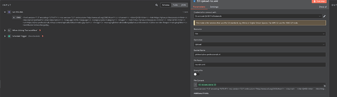

Can’t figure out how to upload a XML file I just downloaded to S3 and have the proper mime-type

And how did you configure your S3 node? Do you have the matching binary field names? What error message do you get if it is not working for you? Your screenshot does not indicate you get one. So, what is not working?

The XML file is uploaded to the S3 bucket without an error. But the mime-type is incorrect. The mime-type is text/html instead of application/xml.
I’m not using binary data as the file contains XML (text data).

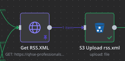

Request headers in Postman
The issue is still not fixed. Any ideas on how to fix this?
Does the binary has MIME type set correctly in the first place? Your screenshot shows the text content. There is no binary file there.
Hey @MikevdBerge - The HTTP request doesn’t give you a binary. You could try this code step in between to set the mime type. This way, AWS will have the correct mime type. Hope this helps.
It works now. Your help is much appreciated. Although I think n8n could set the correct mime-type for binary files like XML files.
