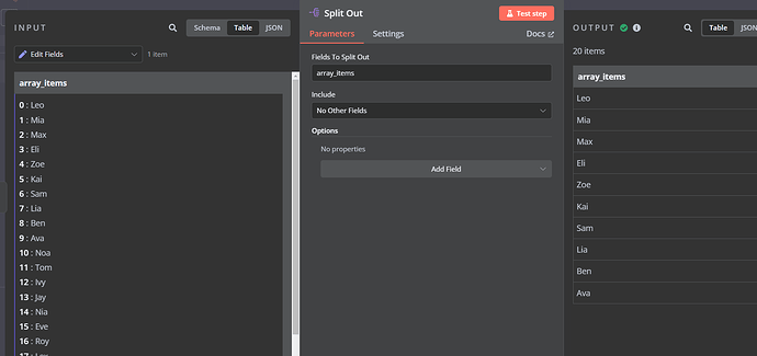

When you split an array you get a list of items:
The workflow will process all those items one by one, without the need for a Loop node.

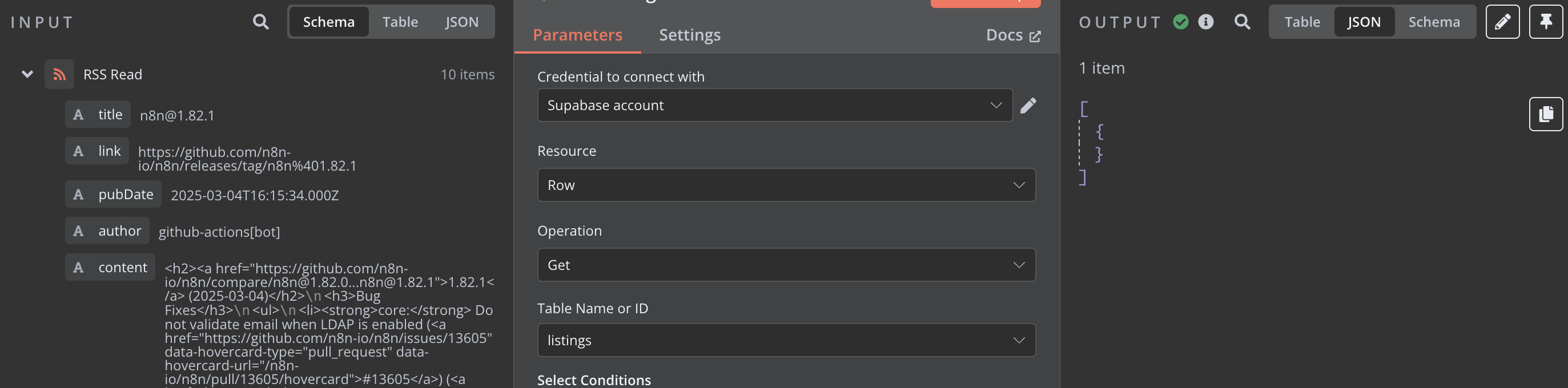

I had the output data even if empty setting turned on before. How exactly do I process the empty ones? Since in my example from 10 items there is only 1 left
When you turn on the option “Always output data”, if 10 items get in, 10 items will also get out.
Can you confirm that behavior from your Supabase node, please?
Unfortunately that is not the behavior but inestead it returns an empty array in the case of not finding one and if some are found the others are being ignored and only the found ones are being returned. That’s my main point why i did it the way i did it, to take each item one by one and loop through them.

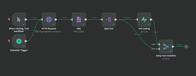

After taking a closer look, here’s a better approach.

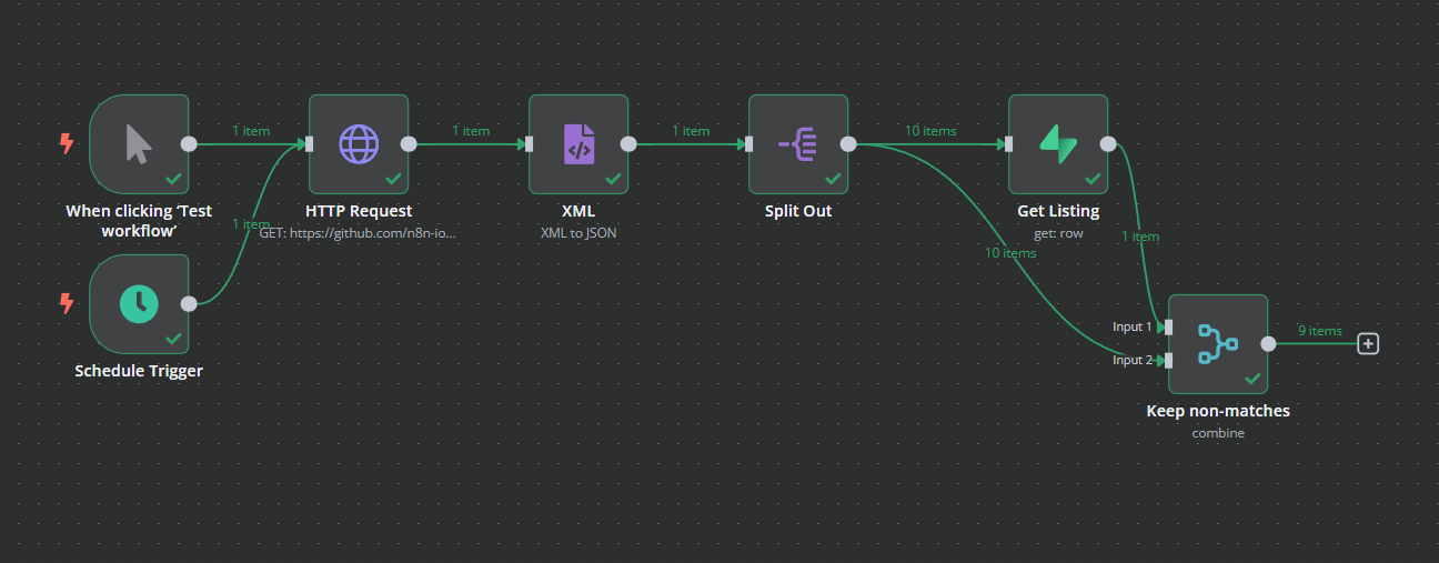

I’ve replaced the FIlter node for a Merge node that keeps the Non-matching items.
See how it keeps only the items that were not found in Supabase:
Let me know if this approach works for you!
