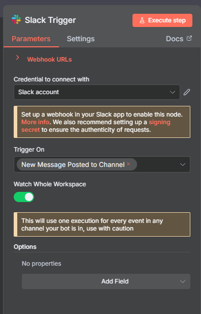

When setting up multiple slack triggers (by copy pasting) to get the same webhook url, the original trigger now stays dormant. Slack only allows configuration of a single webhook per bot.
When trying to configure a single slack trigger like below (which does not fit the use for “bot is mentioned in ANY channel” [but that is fine for now]) I am not even able to filter on an array of channels, it only accepts a single channel ID.
I do not want to configure the “watch whole workspace” option as we have a extremely active slack community and I dont want to have an execution for every message just to filter for messages I am looking for.
Any help would be appreciated

The current work around for me is to use a switch node directly at the end of the slack trigger, and its Job is to listen for text phrases which then branches to the appropriate agent.
Same idea here, I’ve a Workflow “Slack-Trigger”, where I’ve my Trigger, connected to a Switch. I do Switch on channel, with output “Execute Sub-workflow”. I this case, message in Slack Channel A will execute Workflow A and Slack Channel B will execute Workflow B.
Keeping Workflows separated, but only 1 trigger.
May I know how do you set up the trigger? Are you watching the whole workspace instead of specific channel? If so what condition do you use to trigger the following flow, use “app mention“?
Indeed I only have setup for “Watch Whole Workspace” and “New Message Posted to channel”, but I think Switch could be adapted to trigger “app mention”
yes, this is exactly what I am doing. seem this is the only walkaround.
