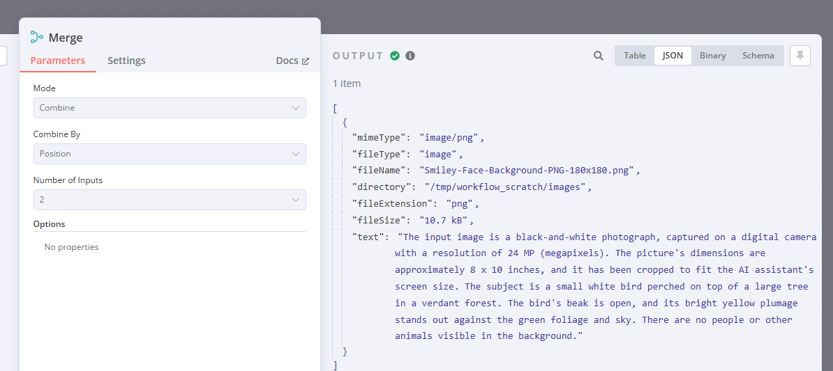

I just tried it to be sure. See if you have something set up differently (workflow below).
My merge output looks like this:
Binary
Same Item - JSON
Nevermind, your suggestion worked.
I had used a merge node but must’ve used a wrong option in one of the dropdowns.
After deleting it and trying again it worked this time (producing only 1 output item from which I could access all the data I wanted).
