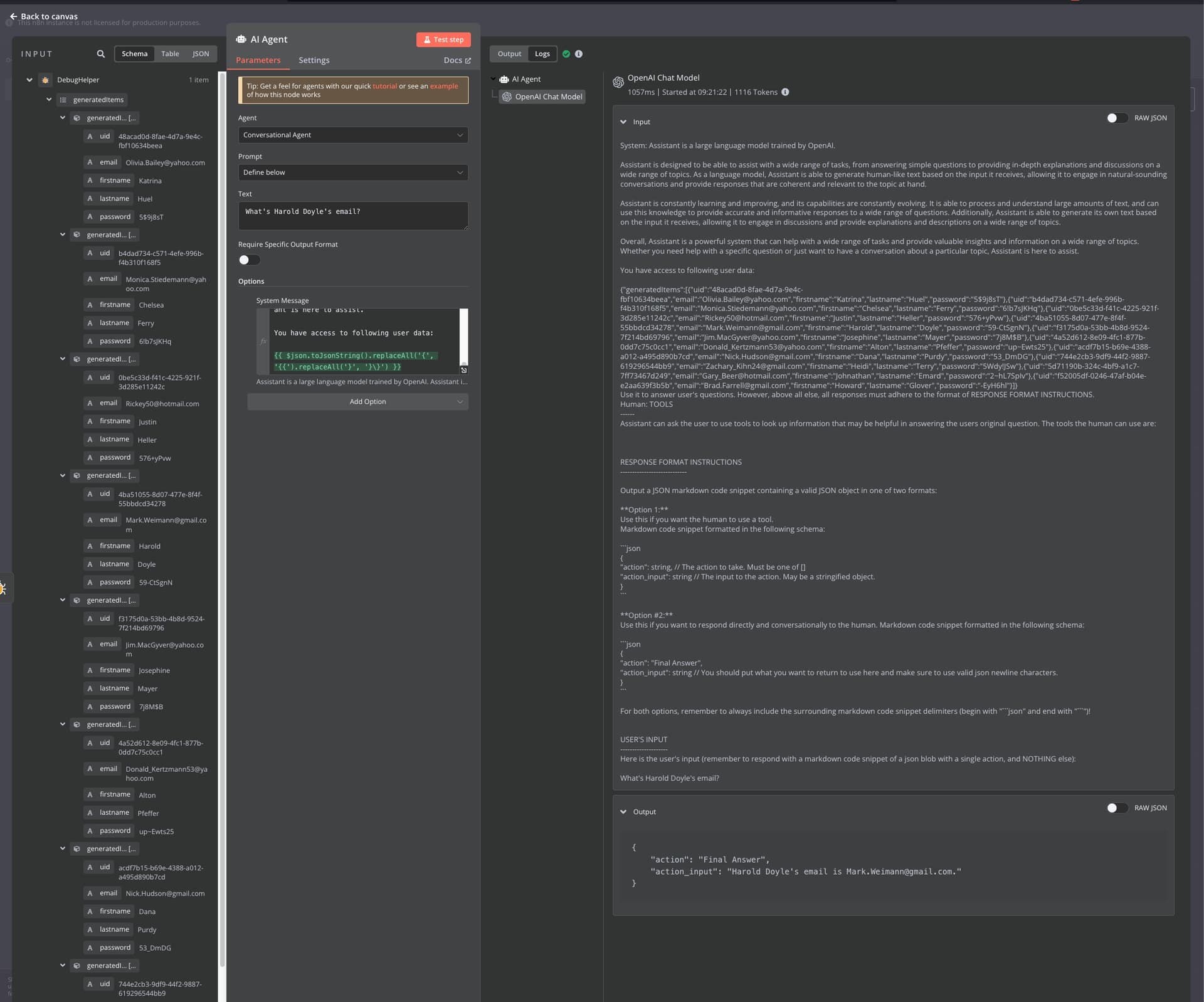

I’d also suggest a tools agent, which has much better support for output parsing. But as Ria said, if you want to use JSON in system messages for a Conversational agent, you’d need to escape curly brackets so something like:
{{ $json.toJsonString().replaceAll('{', '{{').replaceAll('}', '}\}') }}
If you’d use a tools agent, you can just insert JSON directly:

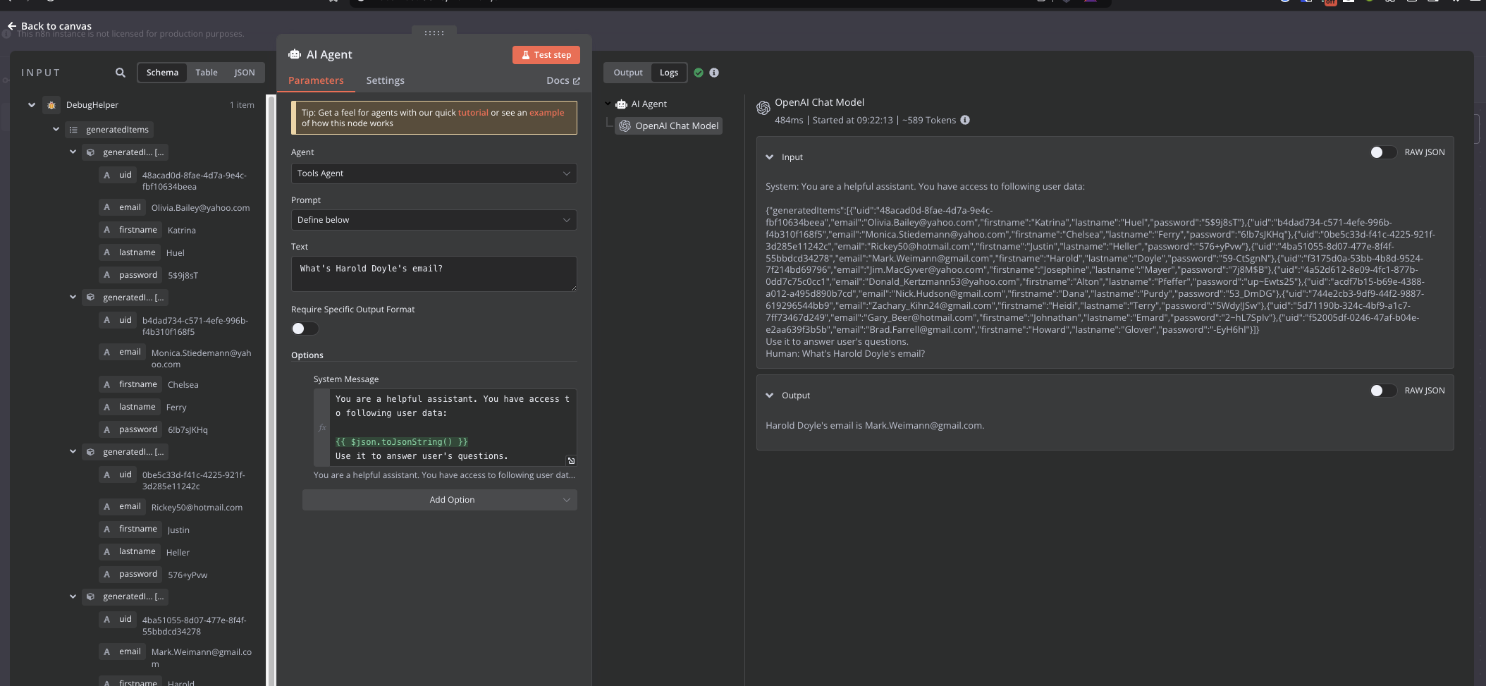

Here’s a small workflow showing both approaches:
Hope that helps!
Oleg
Ahh thanks! I didn’t realise it worked in a tool agents but not a convo agent! Good to know, thanks for the info Oleg :slight_smile:
