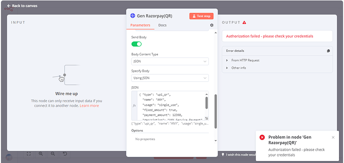

New update with this situation, I have sent the key and secret in base64 format exactly in this format Basic in the header naming Authorization. Now I’m getting empty response, but no qr generated.

Could you please share how you made the Authorization . My authentication is showing failed. And it’s not the quotes, because it’s written in the json in N8N it’s just showing here like that way. The error I’m getting is authentication failed. I’m giving the body exactly copying.
{ "type": "upi_qr",
  "name": "ANY",
  "usage": "single_use",
  "fixed_amount": true,
  "payment_amount": 12390,
  "description": "ANY Service Payment"

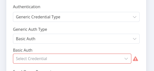

Method: POST
URL: https://api.razorpay.com/v1/payments/qr_codes
Authentication :None
And the headers I mentioned earlier.
Could you please share that what headers you used and exact words .
I think you may be sending the authentication incorrectly. According to their API docs you need to setup Basic Auth. You can do that from within the HTTP request node:
