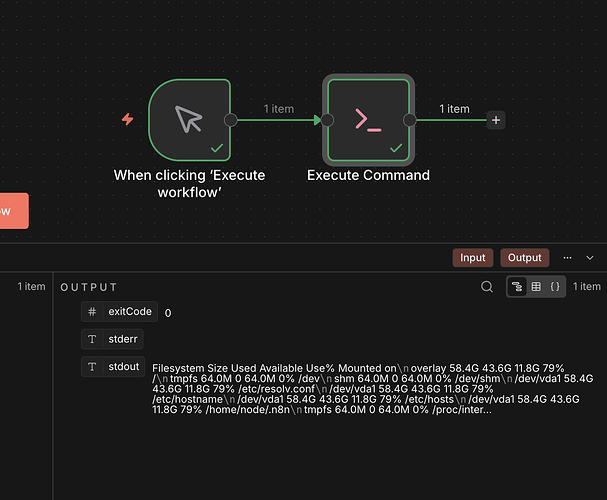

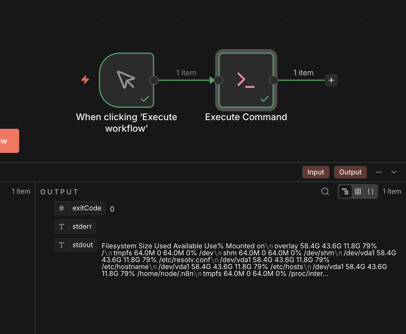

Hi @Issa2024,
Since version 2, you need to enable the execute command node by setting the following env variable. It might be a good idea to read this page in detail to see what else you need to change in all your workflows
NODES_EXCLUDE="[]"
According to the code base of n8n, there are only TWO nodes disabled by default:
So if you do not want to enable the localFileTrigger as well and ONLY execute command, then just add that as the only value in the list:
NODES_EXCLUDE="[n8n-nodes-base.localFileTrigger]"
It looks like you need to enable this env var on both your main as well as worker n8n service in docker

thanks works now
but V2 is big taste !
