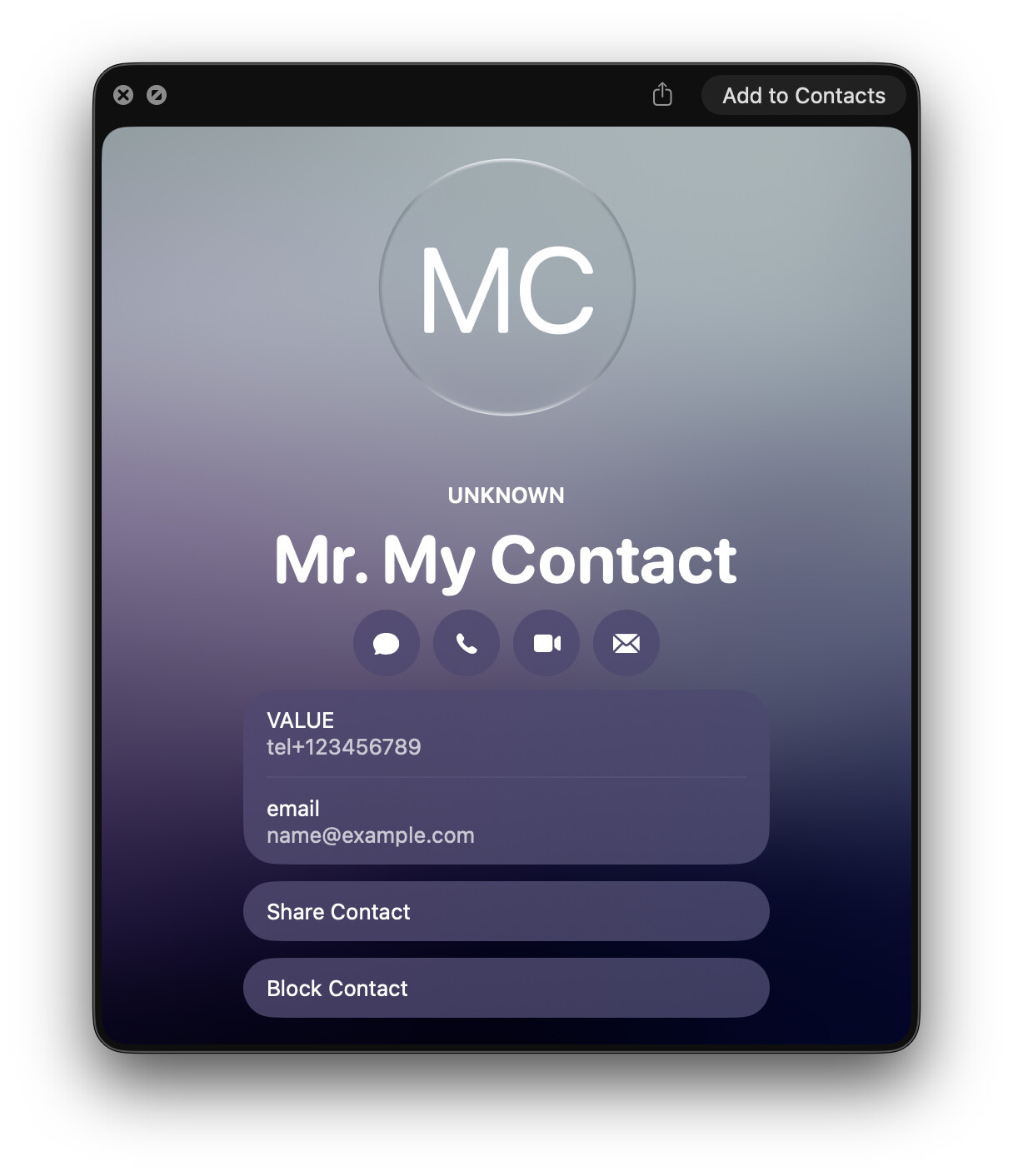

Here is the correct way to do it. You had a few issues in the way you set the data but the core problem was that you tried to convert “base64” to a file from plain text which is just going to corrupt the output of the file because plain text is not valid base64. So I changed it to Convert to Text and set the correct value to use.
This now produced a valid vCard:
Thank you so much!
