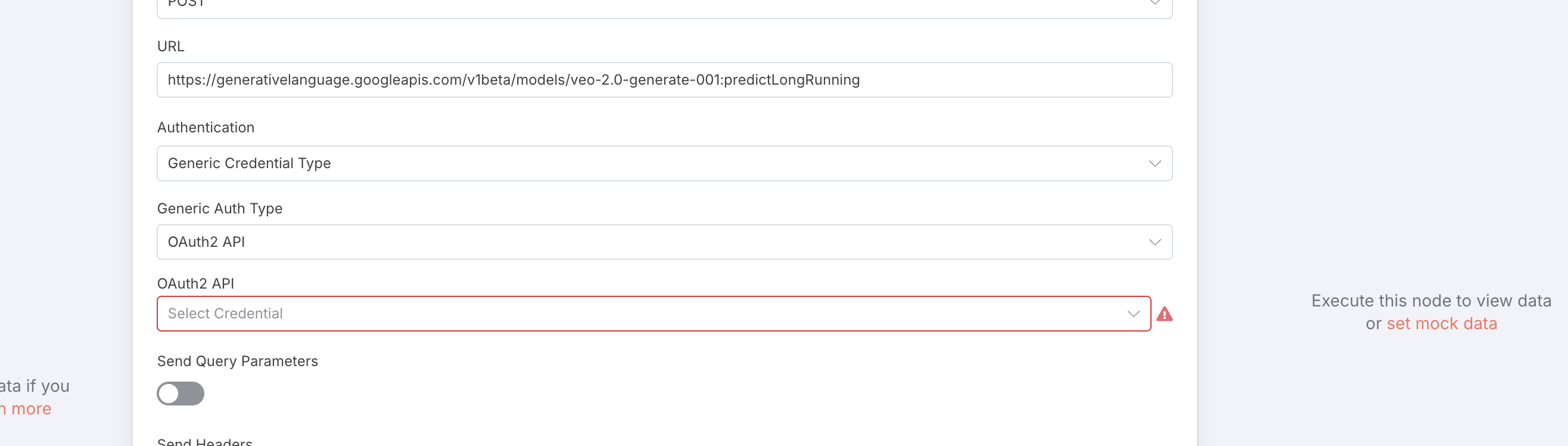

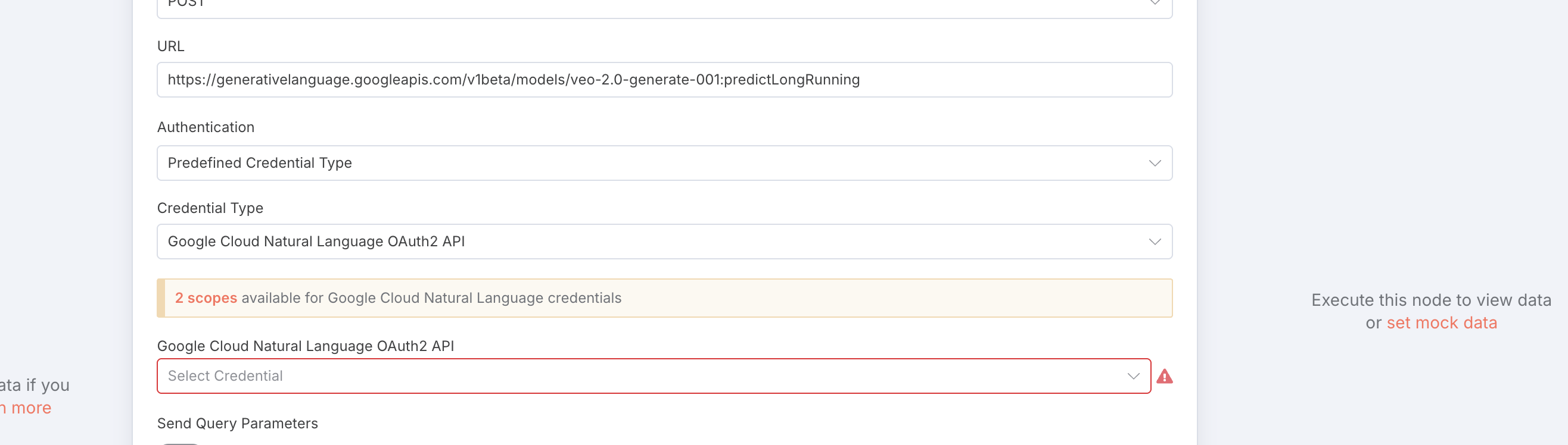

Now, next issue: I have trying to set up OAuth2 and managed all the steps listed on your site. The issue is with the Google API doc which doesn’t specify the scope I need to use for my app. I found 3 (2 restrictred, 1 none) but had no luck at setting these up. If anyone has any reco wtr the scope that is required to access VEO 2, I would be super grateful

So just to confirm, does the scopes appear as error message now? normally you can just add the Gemini api, and enable it. I believe this should add most the scopes needed. (I could be wrong)
But is this all enabled now? and you see the error in n8n for scopes, when making request?

Thanks Samuel. So I checked the N8N supported scope and gemini isn’t there. So instead of Oauth I had to revert back to a service account. I used the predifined credential, got my api calls working with my ai studio key but still get this error message. I guess the model being somewhat new, it ain’t supported yet by n8n so will need to wait I guess. Thanks anyway for all the help, I think we exhausted all paths
