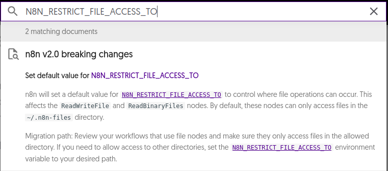

In the docs:
The variable :
Limits access to files in these directories. Provide multiple files as a semicolon-separated list (“;”)….
N8N_RESTRICT_FILE_ACCESS_TO works with directory paths, not with glob patterns like *… and I suppose that meas you can provide multiple directories as a colon-separated list.
Butt the v2.0 breaking-change note suggests that when you allow a directory, file nodes can access files “in the ~/.n8n-files directory”…
Soo…. Is this “recursive”?
Responding as well with a question :thinking: lol.
