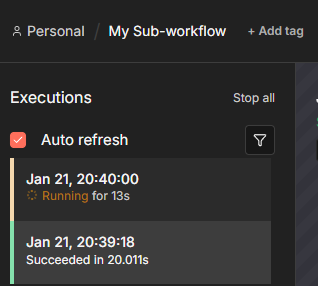

In the main workflow, you won’t see any waiting because “Wait for Sub-Workflow Completion” is turned off,
However, if you check the sub-workflow executions, you’ll see that it behaves as expected: it runs and waits correctly:
