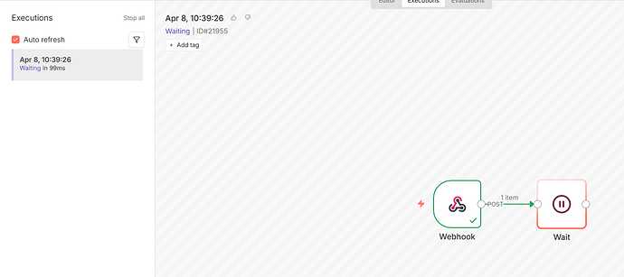

Our n8n version is 2.11.2

Webhook Workflow:
“nodes”: [
“parameters”: {
“httpMethod”: “POST”,
“path”: “webhook”,
“options”: {}
“type”: “n8n-nodes-base.webhook”,
“typeVersion”: 2.1,
“position”: [
12240,
3792
“id”: “bd3044b3-10cb-4c67-8c2f-5b718d5f3832”,
“name”: “Webhook”,
“webhookId”: “d8370d0f-c16c-426e-9860-dc16a3fb83e9”
“parameters”: {
“resume”: “form”,
“formTitle”: “Test Approval”,
“formFields”: {
“values”: [
“fieldLabel”: “Approve or Decline”,
“fieldType”: “radio”,
“defaultValue”: “Approve”,
“fieldOptions”: {
“values”: [
“option”: “Approve”
“option”: “Decline”
“requiredField”: true
“options”: {}
“type”: “n8n-nodes-base.wait”,
“typeVersion”: 1.1,
“position”: [
12448,
3792
“id”: “a47ae90f-266a-449f-8591-5db76a848361”,
“name”: “Wait”,
“webhookId”: “1fe40694-d64a-4823-a7ea-30af1a85e5b9”
“connections”: {
“Webhook”: {
“main”: [
“node”: “Wait”,
“type”: “main”,
“index”: 0
“pinData”: {},
“meta”: {
“instanceId”: “88bde7fa62561e3aec0da846cf229a3a76f95f30f2806f08f58d1a534d2f0004”
Webhook workflow moves to Waitng state, but not getting the Form Pop-up or link to launch the Form Pop-up in the Wait node from executions.
@shakthipsg i think as the flow got executed by the HTTP request maybe that is why it is not showing that auto open popup and not via the n8n ui, i think you can try reading this {{ $execution.resumeFormUrl }} in any of the downstream node you can add maybe send or open that URL and possible everything should be working fine, let me know how that goes.
