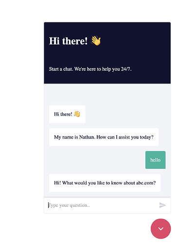

Hi @Hetal,
I am not sure what was wrong with your workflow, but I recreated it and now it works 100%. I think it must have been corrupt somewhere.
PS: I also cleaned up your prompt to use proper markdown for clarity and then please NOTE. The prompt should be set in the System prompt property and NOT the user prompt.
HTML Page:
<!DOCTYPE html>
<html lang="en">
<head>
  <meta charset="UTF-8">
  <meta name="viewport" content="width=device-width, initial-scale=1.0">
  <title>n8n Chat</title>
  <link href="https://cdn.jsdelivr.net/npm/@n8n/chat/dist/style.css" rel="stylesheet" />
</head>
<body>
  <script type="module">
    import { createChat } from 'https://cdn.jsdelivr.net/npm/@n8n/chat/dist/chat.bundle.es.js';
    createChat({
      webhookUrl: 'http://localhost:5678/webhook/933c393f-9691-4465-a1c6-c8c05460a776/chat'
  </script>
</body>
</html>
One change is there I have used tavily for search and response
That is fine, you can connect your Tavily took again. I didnt want to go through the effort of setting up a new Tavily account for me to test with and it was irrelevant to the test. The quote you referenced was a comment that you should use the system prompt instead of the user prompt when using the AI Agent node. It’ll handle the User and System prompts in the back
