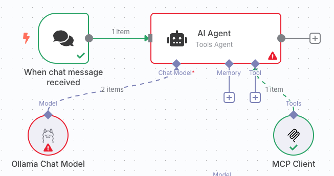

when trying with ollama and a local model like mistral-small3.1:latest I get the error
It is ok when trying with openAI Chat Model (gpt4o-mini)
