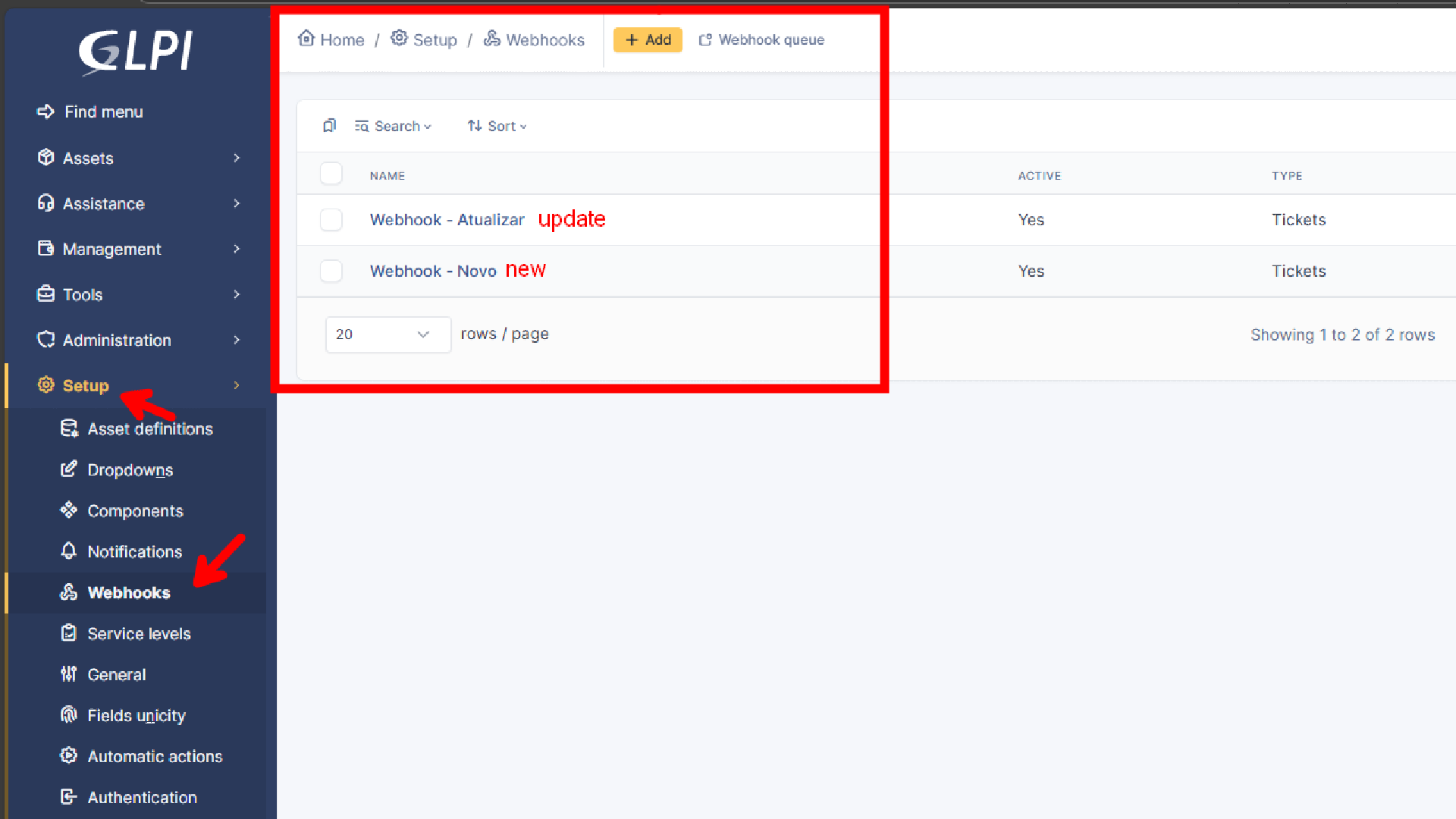

In GLPI, I have already registered two Webhooks: one for “New” and another for “Update”.

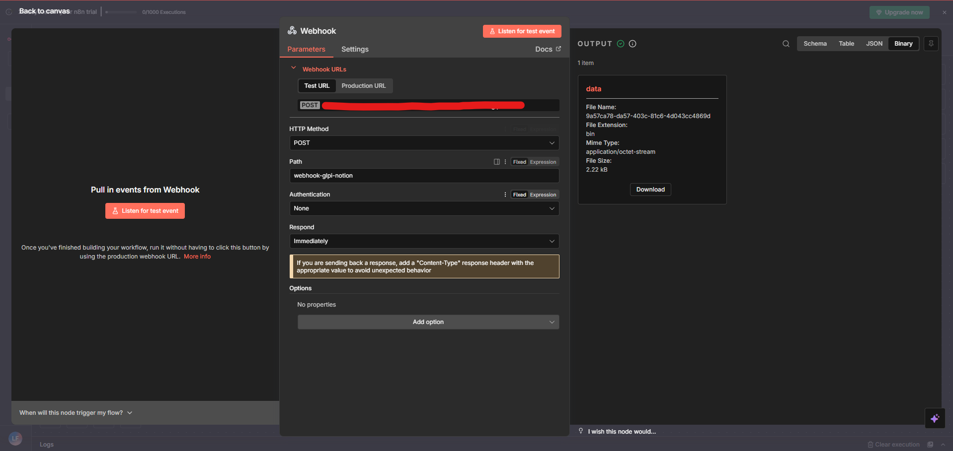

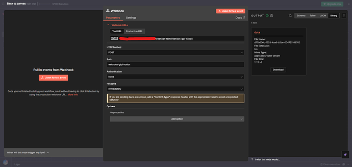

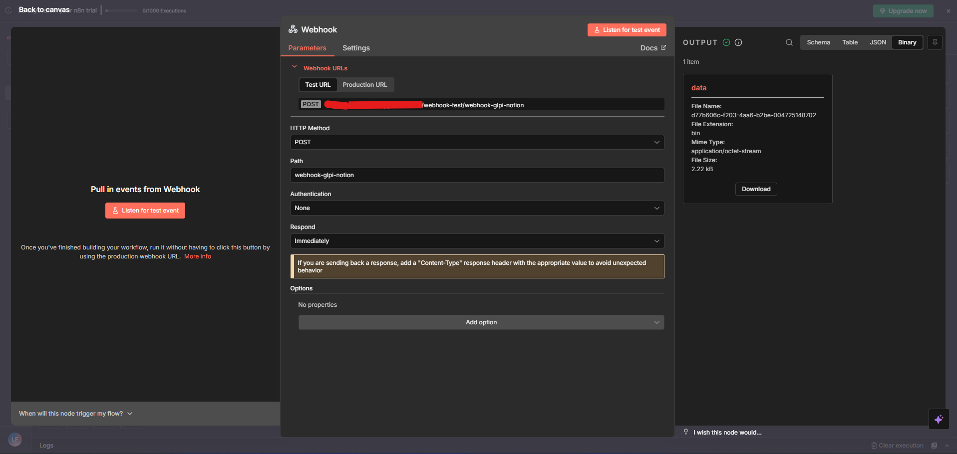

Webhook tests are working on N8N, but the data arrives in binary format.
Is it possible to change how this data arrives (to JSON), or do I need to process it later with another action?
Hello @leandrofelix welcome to :n8n: community!
What you are seeing here is supposed to be what “GLPI” is sending,
Could you check which Content-Type GLPI is using in the Post request payload?
Are you able to control or change that format in “GLPI”?
I forgot to mention that as soon as N8N receives the data from GLPI, it is in binary format.

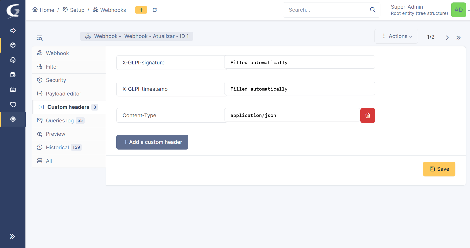

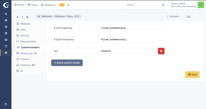

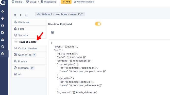

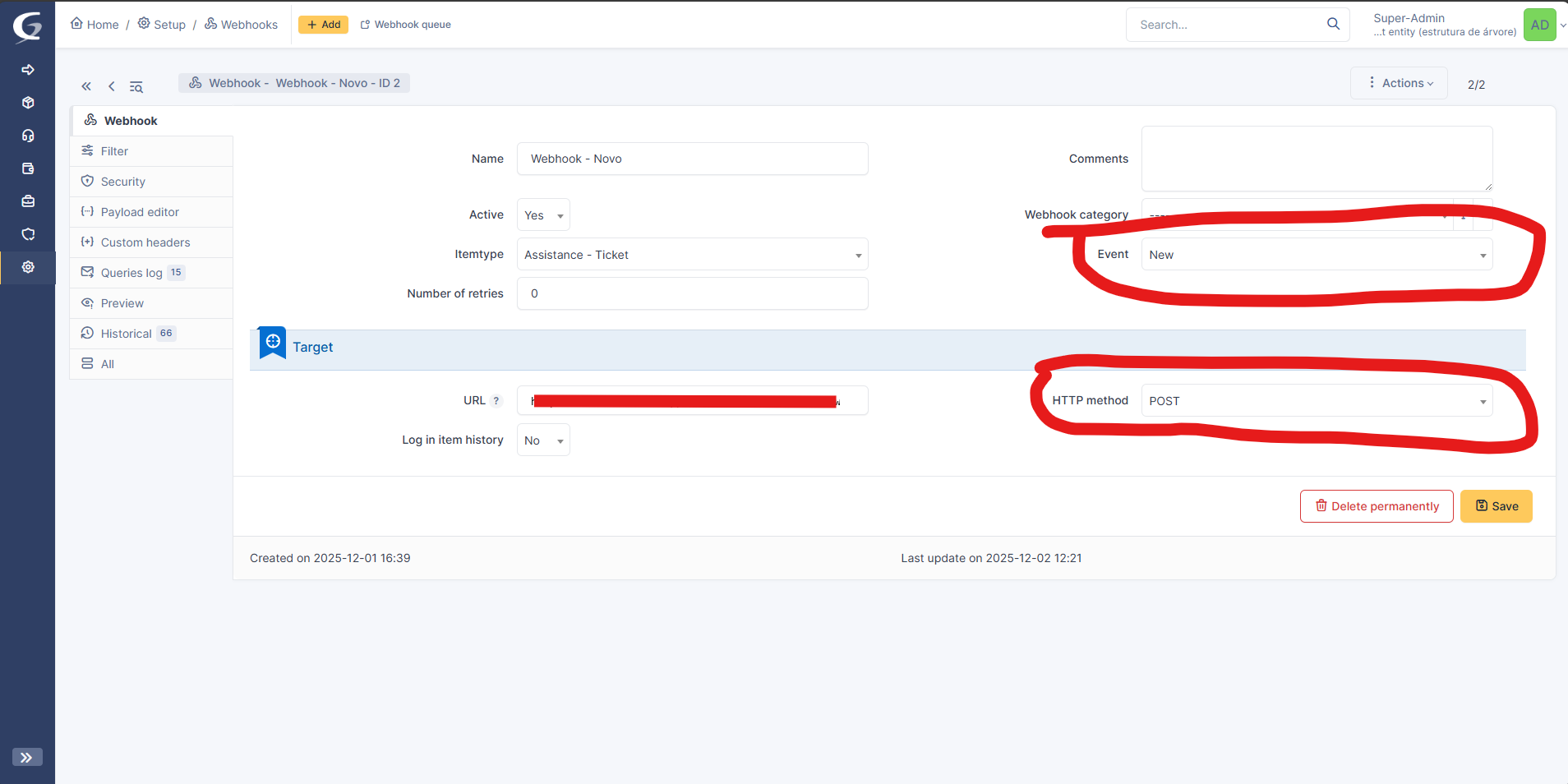

This is the webhook setup in GLPI
What’s in Custom Headers?
@leandrofelix Can you try add:
Content-Type: application/json

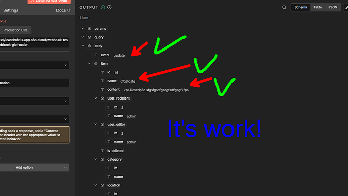

You are the best man!
Thank you so much!
