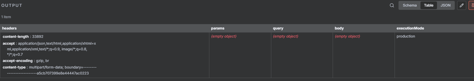

update: i have realized that the “Raw Body” setting also does not return body’s binary file

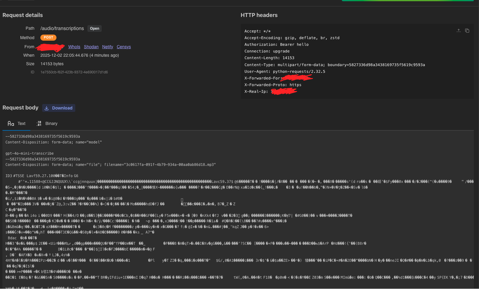

Since i dont have Postman, here’s what im able to catch with my webhook tester setup:
So my guess is that OpenWebUI doesn’t event send out corrent “accept” attribute…
And unfortunately I can’t send the .bin file here, but if i play it in a media player it plays normally
