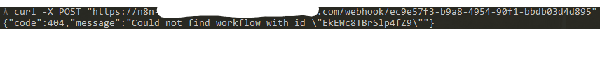

I have created a workflow with only 1 node which is a webhook, configured with POST method.
It works well in test.
But, as soon as it is in produciton, there is a 404 error with the following message :
{“code”:404,“message”:“Could not find workflow with id “EkEWc8TBrSlp4fZ9””}
I have verified that it correspond well to my workflow ID.

Hi! Have you activated your workflow? Your workflow needs to be in active mode for the webhook to work in production mode.
Yes, the workflow is activated :
We found the solution.
It was related to the parameter EXECUTIONS_MODE (Configuring queue mode | n8n Docs)
This parameter was set to QUEUE. It was waiting for workers containers to execute produciton workflows, but there were no workers container here.
Changing this parameter to REGULAR solved the problem.
