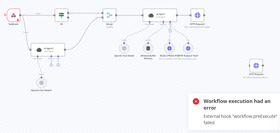

I am experiencing an error when trying to run my Webhook flow in production mode on n8n Cloud. The error appears as:
Workflow execution had an error
The external hook “workflow.preExecute” failed.

In production mode, the Webhook receives the data, but the flow fails before executing the next nodes.
I tested the Webhook URL in cURL and Postman, and the response was:
{ “message”: “Workflow was started” }
This confirms that the URL is active.
Execution stops when trying to pass data from the Webhook to the next nodes.

The issue likely is that you might have exceeded the max number of active workflows on your plan.
In the next version of n8n we’ll surface this error properly, instead of showing that vague error.

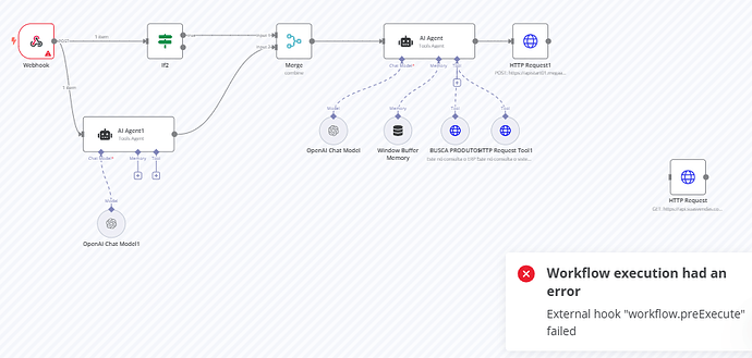

I got this error again!
Problem running workflow
External hook “workflow.preExecute” failed
It’s been so frustrating!
Can anyone help me?
can you please try to upgrade to 1.81 and see if you are still seeing this error :pray:
