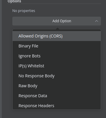

Thanks - that looks like it’d work, but I don’t see the “Continue on Fail” option on the Webhook node…
Options offered are:
options
And webhook node settings are:
settings
NB I noticed it’s Webhook node v1 as oppose to v2, but just tested a v2 node and the options are no different.
Am I missing something?
Thanks
