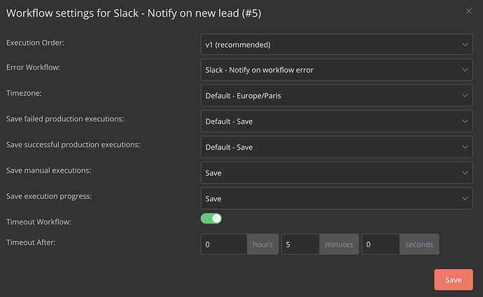

Hi, I have a workflow that usually works fine, triggered by a webhook. But from time to time I get this error message: “no active execution found”, without any information in the execution panel (when I click the webhook trigger to check what’s going on, it’s empty, like if the workflow was trigger but nothing happened).
More details:
  • have a timeout on the whole workflow
  • I have setup an error workflow, which strangely is triggered twice every time it fails. This error workflow btw runs on execution order v0 (it’s an old workflow)
  • the input of the error workflow is

I guess the main workflow stops on “lastNodeExecuted”: “Track Tech Vendors on Cloud Run” which is an http request that probably timeout. Previous nodes executes correctly, but I was expecting to see them at least
Hey @Anthony_Brebion , sounds like the workflow is timing out. If you check the duration of the failed execution what time is reported?
