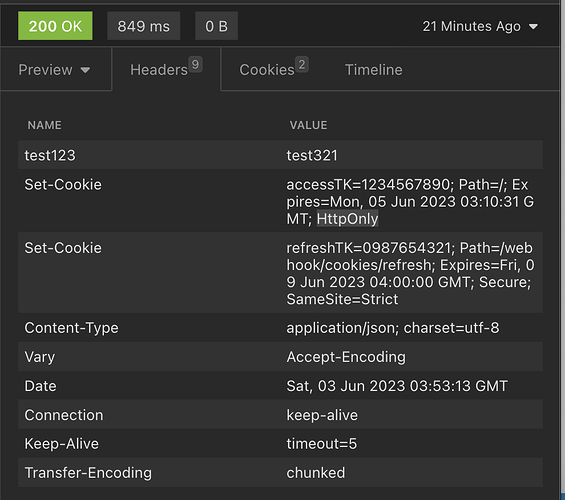

Response sent from n8n:
Received data on the client:
This issue extends to the Webhook node as well.
Data sent from the client:
Data received by the Webhook node.
As seen in the above image, the multiple cookies received have all been clubbed under one header, thus making it infeasible to retrieve each of the cookies individually.
