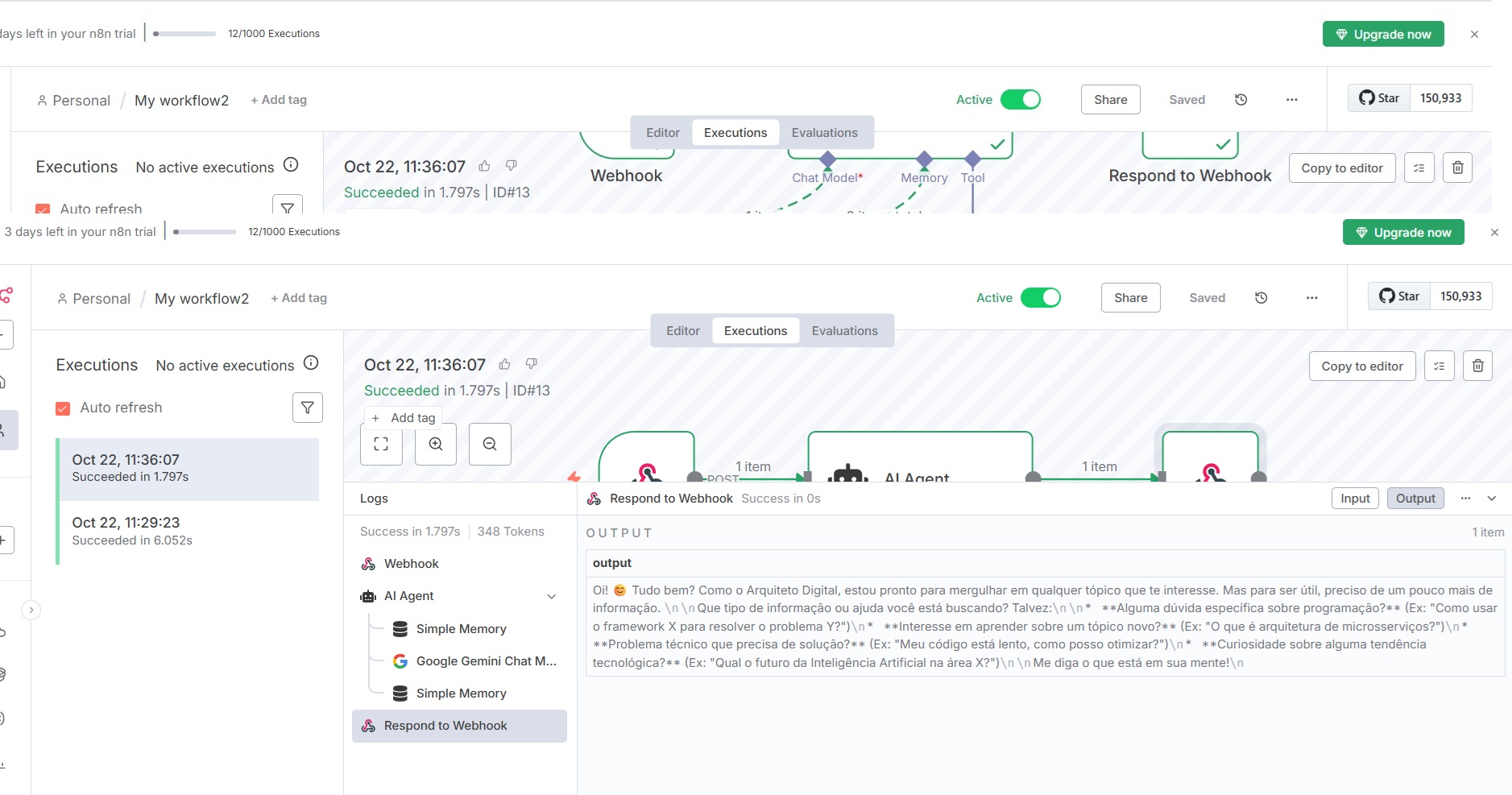

My workflow runs successfully in the “Executions” tab, and the final “Respond to Webhook” node shows the correct JSON output.

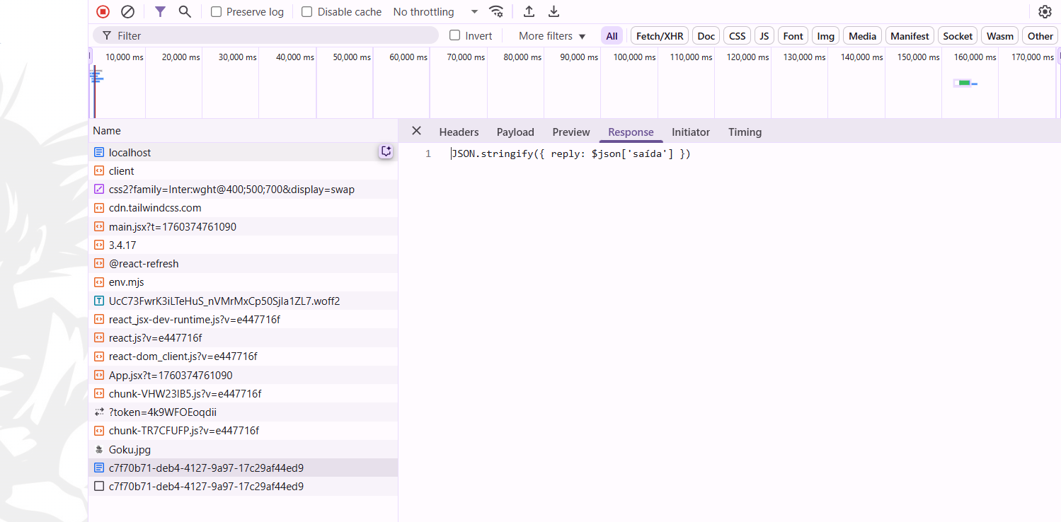

However, when I call the production webhook URL from my application, the browser’s Network tab shows that the server is returning the raw expression text (JSON.stringify(…)) instead of the executed result.

  1. The “Executions” tab showing a successful run:
  2. The browser’s “Network > Response” tab showing the broken text response:

Try to rename the webhook trigger path or remove the simple memory and test again… :slight_smile:
Main Fix Steps
  1. Deactivate → Save → Reactivate your workflow (forces webhook reload).
  2. Restart n8n server / container to clear webhook cache.
  3. Check your “Respond to Webhook” node → remove quotes:
    {{ JSON.stringify($json) }}
    not "JSON.stringify({{ $json }})".
