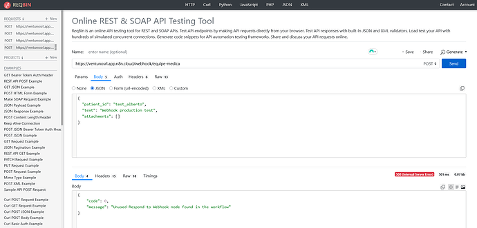

Since you know what informations your webhook receives , make a curl request (Postman/ CLI using cUrl) to your webhook , and see the response.

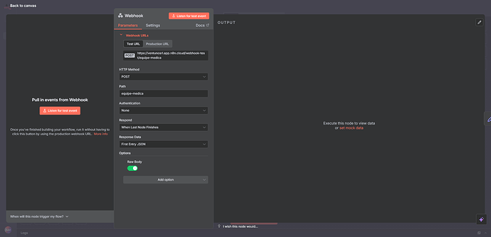

Share an image with the webhook settings …

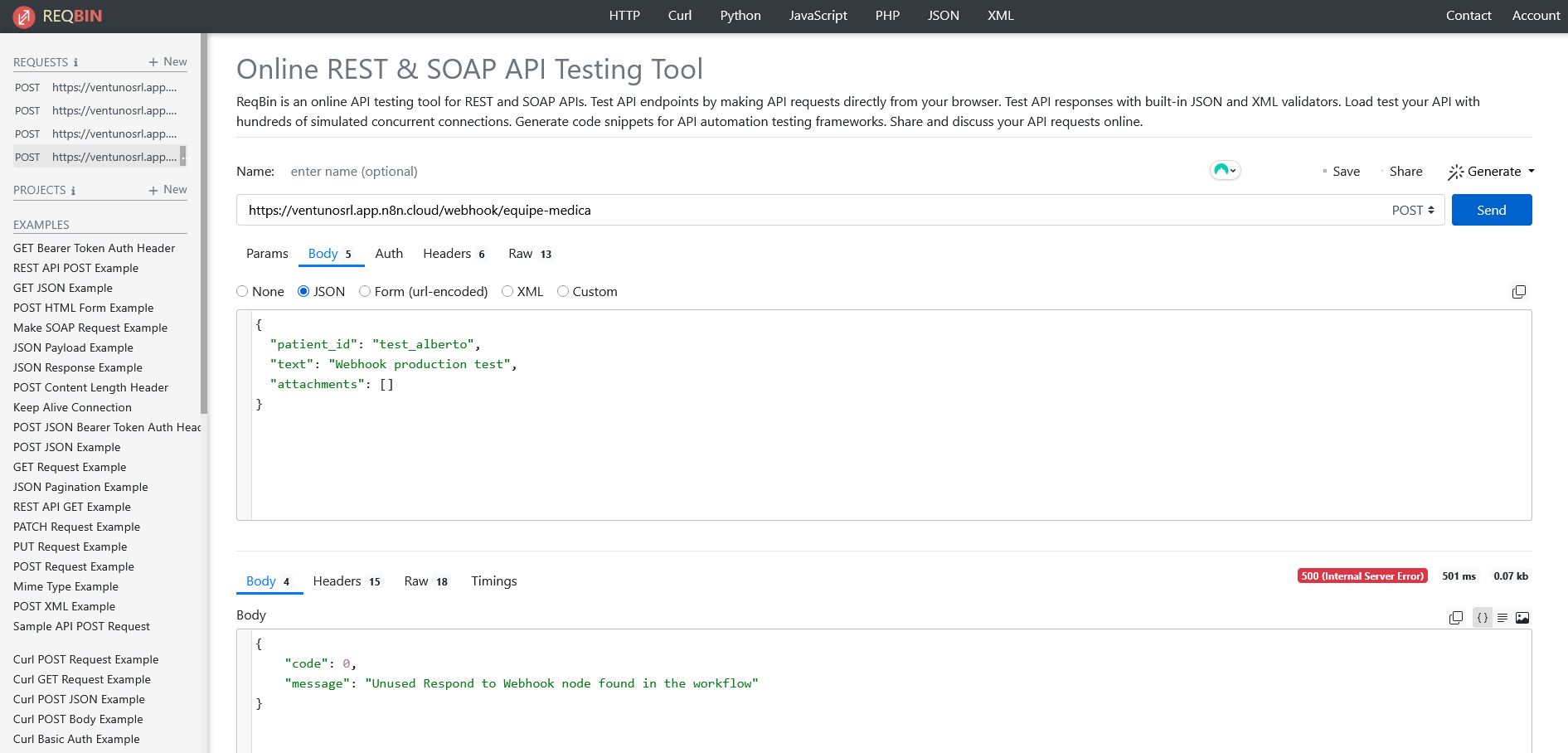

I’ll run a direct test as you suggested with REQBIN . (see attache file workflow001 with error message 500 (Internal Server Error))
I know exactly what the webhook expects (patient_id, text, attachments), so I’ll send a manual POST request using cURL / Postman (or ReqBin) to the production URL and check if any response is returned.
file worrkflow002 and workflow003 show setting in testurl and productionurl

As you can see in the body response, you have a respond to webhook node at the end of your workflow (it seems that your Webhook trigger has other options selected , it will respond anyway.) .
Remove that at the end, or change the option.
