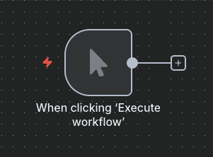

Usually this behaviour is something that happens when you try to add the “next” (not a trigger) nodes to the canvas which doesn’t already have a trigger. Does your first node, which you referred to as the “Start Node” look anything like this:
Make sure that your first node is actually a trigger.

Remove the “Start node” and add one called “Trigger manually”. Then try to add more nodes at the end. Many nodes in your workflow is VERY outdated or completely deprecated (like the Start node). This is the cost of letting AI Assistant build your workflow.
