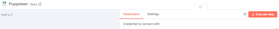

Whats Credential to connect with in the Puppeteer node

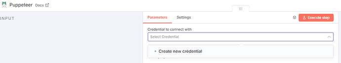

I’m having an issue with puppeteer, where at the top it’s asking for Credential to connect with
Can someone please explain, what is it? what creds do I need for this to work?

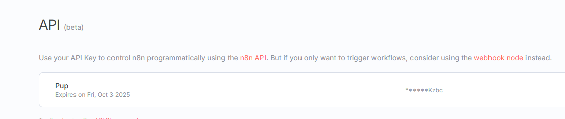

I got the API up:

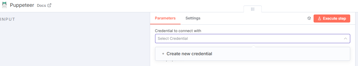

But nothing shows up in the “Select Credential to connect with“ drop box:
What am I missing?
Thank for the help so far
It was a brain fart, all is OK now.
