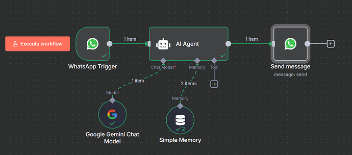

Hi All,

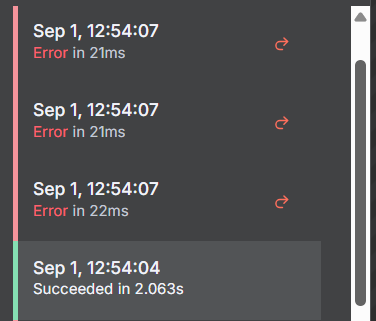

I have created this workflow, which is working fine, and I am getting responses on WhatsApp.
However, when I check executions, I see some errors after successful execution.
Need help, please.

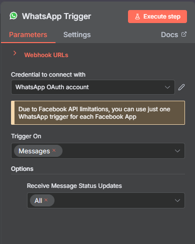

Hi @imran537
Did you select any “Trigger On” options other than “Messages” here:
I think the workflow is being triggered by something other than “Messages”..

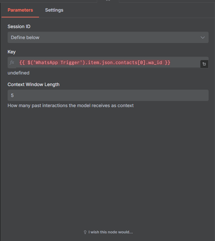

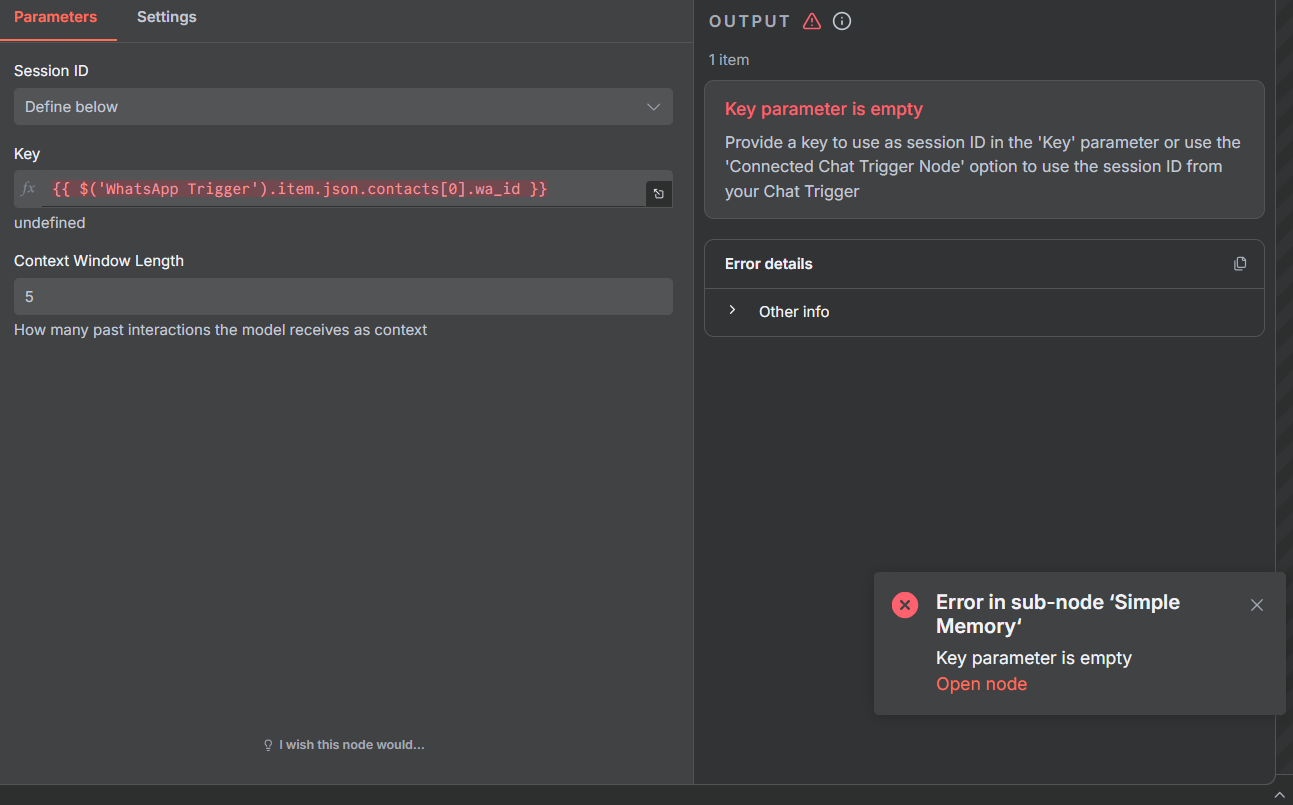

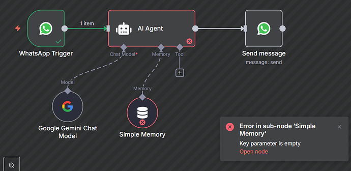

@mohamed3nan I have further investigated the issue, and this is what I found.
Workflow executes successfully, and then the memory node and the WhatsApp send message node give an error.
Here is the memory error:

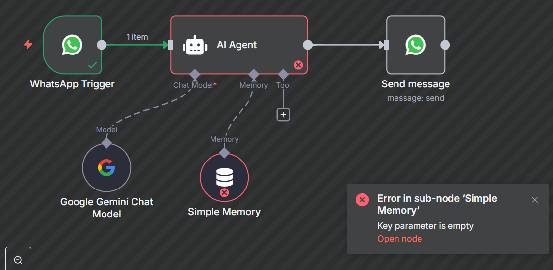

Please help1
Can you just confirm that you only configered the “Messeges” triggers only?
Yes, only messages is selected without any other properties.

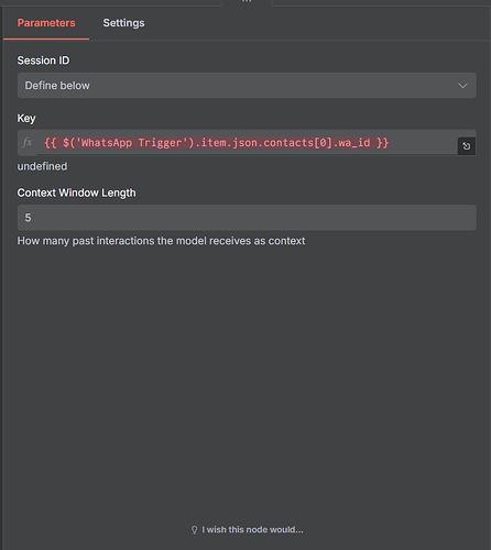

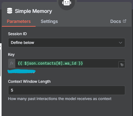

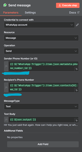

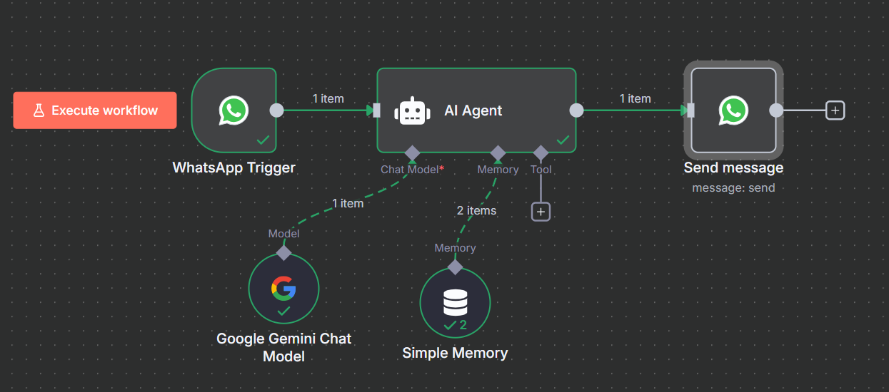

hi @imran537
This is how the memory node should look:
And this is how the WhatsApp send message node looks:
Could you please try the following example?
I tested it on my end and didn’t encounter any issues:
