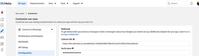

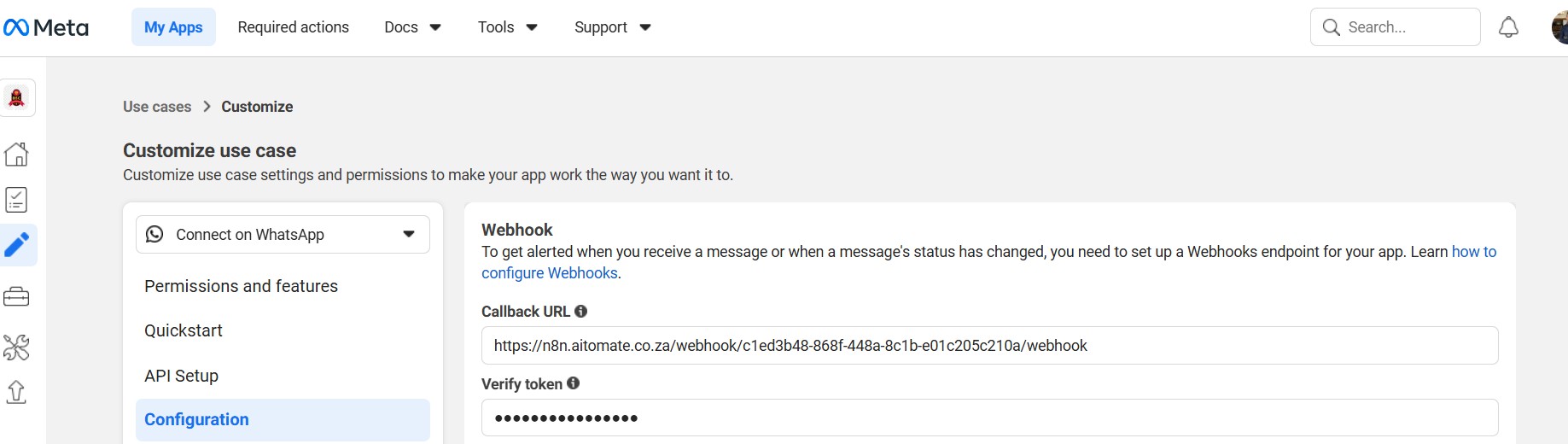

Whatsapp Trigger Node produces 429 Response on Publish
You are absolutely right the native WhatsApp node locks that token away internally, which is exactly why you are stuck in this loop.
Try this: The Manual Handshake:
• Delete the WhatsApp Trigger and add a standard Webhook node.
• Set the Method to GET and the Path to whatsapp.
• Connect a Respond to Webhook node to it.
• Set the Response Body option to {{ $json.query['hub.challenge'] }}.
• Go to the Meta Console, enter your new URL (e.g. .../webhook/whatsapp), type any random token (like 12345), and click Verify.
• Once you get the green success message, switch the Webhook node Method to POST to start receiving actual messages.
This tricks Meta into verifying your URL without needing the specific token from the broken trigger node.
Let me know if that finally gets you the green checkmark.
