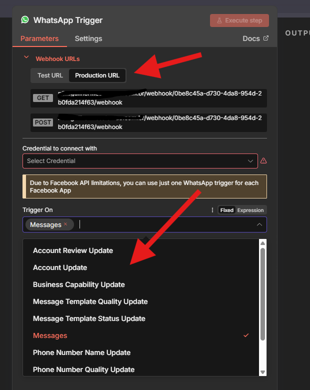

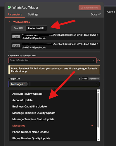

Try the following:
  • Make sure your workflow is published.
  • Make sure you are using the Production URL of your webhook, not the Test URL.
  • Select all possible fields on “Trigger On”
