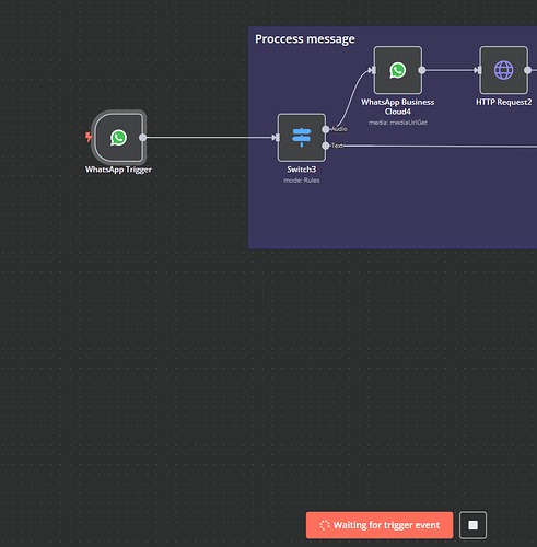

Everything was working fine for six days, but today the WhatsApp trigger is not working correctly. It remains stuck on ‘waiting for trigger event’ regardless of how many messages I send, and I can’t stop it either. What can I do to fix this?

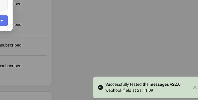

WhatsApp Business Manager, tests from the Meta server side are OK, but on my side the trigger is not responding to the stop command. Incoming data is not registered. Executions are not available for debugging…

At the moment, I’m saving my project every time, go back to the main menu (overview) and go back into the project. That’s apparently the only way to kick it back to life.
Another detail: while the webhook keeps indicating it is waiting for an event, it isn’t doing so. After the first event coming in, it stops listening.
Once the project is active, it will listen without interruption, thank goodness…

What you are describing is the expected test behavior of the node. When you click Test Workflow (or Test Step in the node itself) the webhook listens for the next one event and then stops again.
This is to provide you with “fresh” data input for your workflow for testing. You can then pin the data in order to not having to test the node/workflow all the time as that would keep making new calls.
When you’re done building your workflow you can then save it and activate it. This will then “turn on” the trigger node and basically put the webhook in production mode.
Hope that makes sense :slight_smile:
